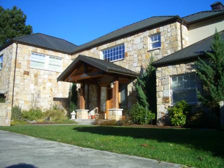

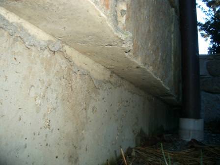

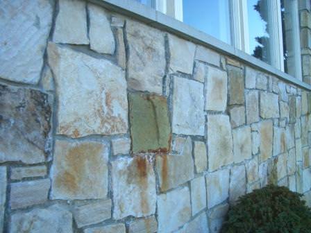

randynavarro Posted February 3, 2007 Report Share Posted February 3, 2007 This isn't a trick question. House is 1998. Stone veneer covers probably 80% of the exterior. Just curious to see what others would write regarding these details . . . if you think anything is wrong? Download Attachment: FullExterior.JPG 64.89 KB Download Attachment: WindowDetail.JPG 53.4 KB Download Attachment: NoBrickLedge1.JPG 56.98 KB Download Attachment: NoBrickLedge2.JPG 54.16 KB Download Attachment: EfflorescenceUnderWindow1.JPG 61.15 KB Quote Link to comment Share on other sites More sharing options...
hausdok Posted February 3, 2007 Report Share Posted February 3, 2007 Hi Randy, Is it real stone or cast stone? It kind of looks like cast stone to me but the photos have been taken at an oblique angle that prevents me from seeing whether any of them are identical. If it's cast (faux) stone, it does not need a brick ledge. Think of it more as a very rough and blocky stucco coat. It is bonded to mortar laid over an extruded metal lath that's attached to the exterior. It has to drain just like stucco and the same clearance for drainage rules apply to the bottom of the veneer at the exterior. It shouldn't be any closer than 2-inches to flatwork or about 4 inches to grade. The perimeter of the windows should be sealed with backer rod (Backerseal works best) and the surface of the joints tooled with butyl. If it's faux stone, just think of it and inspect it like you're inspecting a stucco exterior and you won't have a problem making the right calls. ONE TEAM - ONE FIGHT!!! Mike Quote Link to comment Share on other sites More sharing options...

randynavarro Posted February 3, 2007 Author Report Share Posted February 3, 2007 Is it real stone or cast stone? It sure looked real to me. Too irregular and organic. I was curious how they got so many nice exterior corners, though. Got weep holes/weep screed? None I assume that moisture infiltration around the doors and windows is a problem, but how can that be ascertained? That's the hard part. I found a water-damaged interior window sill, mold growth on the bottom of the drywall on one wall of the garage (bottom of exterior rock was buried in the soil at this area), and pockets of rot in the crawlspace along the bottoms of the walls - but not all walls. I usually don't do much follow up after I leave a property, but I think I might on this one. Not sure what they're going to do to have any testing. I basically told them the only way I know is to do some destructve investigation. BTW, the other 20% of the home was stucco. A stucco expert will be drilling and probing the parts of the walls that I'm almost positive will have issues. Quote Link to comment Share on other sites More sharing options...

BADAIR Posted February 6, 2007 Report Share Posted February 6, 2007 Bottom corners are where you can tell natural from most cast systems. Cast may have "L" shape pieces at inside and outside corners. Mirror works great for low terminations. Of course the substrate attachment is critical when "glued" systems are used. Cast is still much heavier than any stucco applications I've encountered. I hand pressure test for wall movement at numerous locations especially windows and doors, as I do on any brick veneer, any movement and the substrate is not correctly secured or fasteners are failing. Hollow tapping like EIFS or loose tiling often means problems underneath the surface. I see problems with these all to often. Quote Link to comment Share on other sites More sharing options...

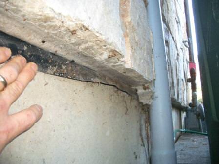

randynavarro Posted February 6, 2007 Author Report Share Posted February 6, 2007 Follow Up. The exterior / stucco specialist completed his inspection. Yes, the stone is real. Yes, there is a drainage plane / barrier - that's what the plastic is coming from out and under the stone in this photo: Download Attachment: NoBrickLedge1.JPG 56.98 KB He sez its a neoprene gasket type material that masons use these days to seal the stone behind and then they drop it over the ledge of the foundation. He couldn't physically verify a brick ledge but thinks the stone is sitting on a recessed shelf on the foundation. He also concurs with my thinking that cultured stone is becoming the next EIFS He's already inspecting plenty of places in our area that he's finding significant issues with. Quote Link to comment Share on other sites More sharing options...
BADAIR Posted February 7, 2007 Report Share Posted February 7, 2007 Randy, Maybe it's the eternal optimist in me but I think the "exterior / stucco specialist" is blowing bubbles up your skirt. That "membrane" sure looks like the sill poly we use down here. Why would they over hang the ledge by what looks to be 2"? Did the plans spec this? Quote Link to comment Share on other sites More sharing options...
randynavarro Posted February 7, 2007 Author Report Share Posted February 7, 2007 Originally posted by BADAIR Randy, Maybe it's the eternal optimist in me but I think the "exterior / stucco specialist" is blowing bubbles up your skirt. How did you know I wear a skirt? That's private. That "membrane" sure looks like the sill poly we use down here. Why would they over hang the ledge by what looks to be 2"? Well, I'm not sure I buy it either but I'm not a masonry expert. Remember, this is the Northwest - lots of cedar, fiber-cement lap siding. . . and LP and Weyerhaueser lap siding. Did the plans spec this? No idea. The architect and masonry contractor were meeting at the property today to review other issues that I and the stucco inspector found. I'm already off and running to other inspections - wish I had time to follow up on some of these issues, but . . . Quote Link to comment Share on other sites More sharing options...
