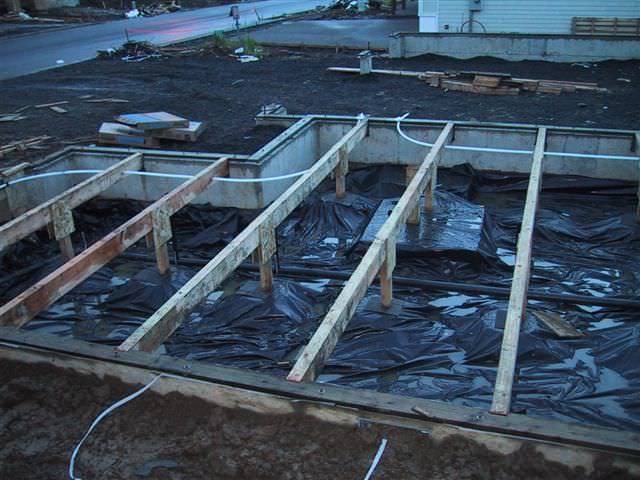

Richard Moore Posted February 11, 2007 Report Share Posted February 11, 2007 Originally posted by Jim Katen Think railroad cars. It's 2x6 t&g hemlock. Around here, we build our first floors with 4x6 girders every four feet and 2x6 car decking on top of them. No joists, no plywood. - Jim Katen, Oregon Jim, I often see that, in fact it is probably the norm, in 50's to 70's ramblers, but I can't remember ever seeing it on anything much newer than that or at the first floor of a two-story home. You guys still build that way down there? Quote Link to comment Share on other sites More sharing options...

Jim Katen Posted February 11, 2007 Author Report Share Posted February 11, 2007 Originally posted by Richard Moore Originally posted by Jim Katen Think railroad cars. It's 2x6 t&g hemlock. Around here, we build our first floors with 4x6 girders every four feet and 2x6 car decking on top of them. No joists, no plywood. - Jim Katen, Oregon Jim, I often see that, in fact it is probably the norm, in 50's to 70's ramblers, but I can't remember ever seeing it on anything much newer than that or at the first floor of a two-story home. You guys still build that way down there? Download Attachment: CarDeckFraming.JPG 72.8 KB Quote Link to comment Share on other sites More sharing options...
