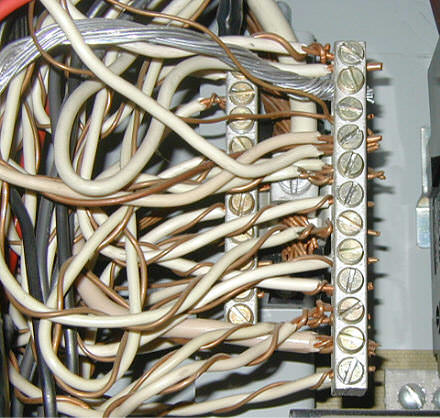

denable Posted February 28, 2004 Report Share Posted February 28, 2004 Doug, The attached photo shows part of a panel that was around 25 years old. These were the only two bars for the neutrals and grounds. What if anything would you comment on. Dennis Download Attachment: panel.jpg 60.22 KB Quote Link to comment Share on other sites More sharing options...

Brian G Posted February 29, 2004 Report Share Posted February 29, 2004 Originally posted by denable The attached photo shows part of a panel that was around 25 years old. These were the only two bars for the neutrals and grounds. What if anything would you comment on. Yep, I've run into that too. Flat-out not enough terminals to comply with the rules. I tell clients that the only possible relief I can see is to add equipment ground bars (linked the the neutral bars by a piece of wire, just to be sure) and move all of the equipment grounds over there to make room on the neutral bars. I also tell them to consult a qualified electrician about that and / or other options. I don't think anyone has done it yet, but I don't see why it wouldn't work if done properly. Douglas, any potential pitfalls come to mind? Brian G. Genius / Idiot..You Make the Call Quote Link to comment Share on other sites More sharing options...
Brian G Posted February 29, 2004 Report Share Posted February 29, 2004 Originally posted by hausdok Yes, Grounds doubled in the bus, okay, neutrals doubled in the bus.....NOT! In fact, if I'm not mistaken you can have as many equipment grounds as will fit in a terminal. I've seen 4 or 5 per on occasion. Brian G. Quote Link to comment Share on other sites More sharing options...
