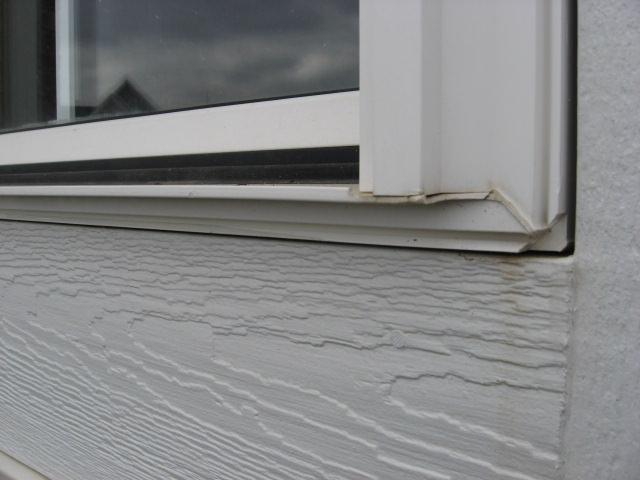

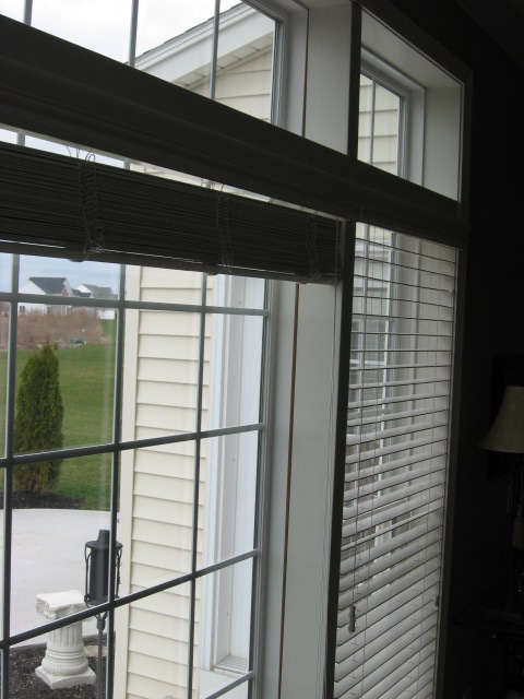

dtontarski Posted April 3, 2007 Report Share Posted April 3, 2007 I inspected a 2-year old home built by quote "one of the areas top builders" yesterday. There was a 5x7' fixed window (vinyl framed/insulated glass) in the family room. The window frame (the vertical 7' side) was bowed out in the center approximately 5/16" on both sides. The current owner was told by the builder that this gap was necessary in order to allow the window to flex against the wind. Opinions on this? Download Attachment: Tom Ewing 080.jpg 97.71 KB Download Attachment: Tom Ewing 079.jpg 56.6 KB Quote Link to comment Share on other sites More sharing options...
hausdok Posted April 3, 2007 Report Share Posted April 3, 2007 Hi, That's bullshift, to use WJ's term. Vinyl windows expand at twice the rate of aluminum, wood or fiberglass windows and their rough openings need to be slightly larger to accommodate that additional expansion. Otherwise, the outside perimeter of the window gets constrained and when it expands it has nowhere to go but outward. Ergo, the gaps. That builder has his head tucked up his assets. ONE TEAM - ONE FIGHT!!! Mike Quote Link to comment Share on other sites More sharing options...
dtontarski Posted April 3, 2007 Author Report Share Posted April 3, 2007 Thanks Mike. Your opinion and the reasoning behind it reinforces what I understood about it. The collective opinions of the experienced individuals on this site helps us all report with confidence. Another window question - more photos attached -Wouldn't best practice be that all exterior window to trim seams be caulked against driving rain? Download Attachment: Tom Ewing 031.jpg 80.39 KB Download Attachment: Tom Ewing 045.jpg 57.96 KB Quote Link to comment Share on other sites More sharing options...
hausdok Posted April 3, 2007 Report Share Posted April 3, 2007 Phew! That's a seriously cheap-quality vinyl window! I wouldn't expect that to stay leak-free for very long, no matter how well they detail it. To answer your question, caulk should not be a substitute for good workmanship. If the window has head flashings and you're confident that it's been properly splined (flashed) beneath that trim and siding, it's not absolutely necessary to caulk that joint. If there aren't any head flashings, the caulk is usually used, in addition to whatever has been used behind the trim/siding to flash the window, and essentially represents a figurative pair of crossed fingers while hoping they got the bitumen detailed correctly. With the vinyl window, the caulk is liable to fail anyway, unless it can move with the expansion/contraction of the window without failing. There is one caulk that might work with that - Big Stretch by Sashco - it's a butyl formulation that doesn't harden and has some amazing elastic qualities. If it's compatible with vinyl and will bond to vinyl and cure properly, it might be worth caulking those joints just to give it a more finished look, but I'd probably leave the bottom un-caulked, just so's there's another path for water to get out from behind the frame and siding should infiltration occur. I should probably add that you'd normally want to use backer rod in anything wider than about 3/16 inch, but with a vinyl window that's not a great idea, because you'll constrain it. That vinyl will want to expand in summer and that gap is liable to close. Pack it with a bunch of backer rod and you probably won't be able to get them open come summer. OT - OF!!! M. Quote Link to comment Share on other sites More sharing options...
