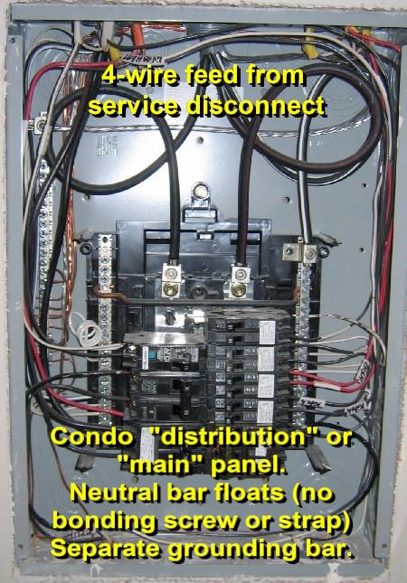

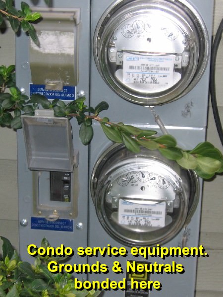

Richard Moore Posted May 11, 2007 Report Share Posted May 11, 2007 They say a picture is worth a thousand words. Here's 2000. A very typical and correct townhouse/condo set-up. Download Attachment: condoservice.JPG 93.51 KB Download Attachment: condopanel2.JPG 135.3 KB I don't really care if the NEC uses the term "sub-panel" or not. Electricians do. However, I do think it should be reserved for a panel fed from a breaker other than the service disconnect. My terminology... Service Disconnect: Wherever it is. Service Panel: The distribution panel, only if it contains the service disconnect (my clients don't understand "service equipment"). Distribution Panel, Main Panel or just Panel: The first distribution panel if there's a remote disconnect. May have a "Main" breaker or not. Sub Panel: Subsequent panel fed from a breaker within a distribution or service panel (or anything after that). I try to stick to that. Edited because I grabbed a photo of a screwed up condo panel first. Download Attachment: 0032.JPG 60.07 KB Quote Link to comment Share on other sites More sharing options...
Brian G Posted May 11, 2007 Report Share Posted May 11, 2007 Richard, in "condopanel" it looks like the 4th wire from the feed (the "wrapped" equipment ground) is terminated on the neutral bar, not on the equipment ground bar. Am I seeing that right? Brian G. Say It Ain't So [:-bigeyes Quote Link to comment Share on other sites More sharing options...
Richard Moore Posted May 11, 2007 Report Share Posted May 11, 2007 Yep...see my edit above. The last (0032) photo was in the report. Good eye sir! I somehow managed to add the wording without noticing I had grabbed a bad one. I caught it when I checked the post image (probably at the same time as you). For others...the new condopanel2 photo isn't what Brian was talking about. It was a larger photo of the 0032 panel. Now I've confused everyone! [:-banghea That was a new home. Signed off. No reliable path back to the utility grounded conductor to clear a ground fault. "Do I need an inspection on a new home?" Yes, Ma'am! Quote Link to comment Share on other sites More sharing options...

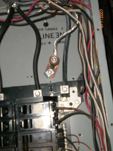

ctgo4it Posted May 13, 2007 Author Report Share Posted May 13, 2007 Here are the pictures (finally!) The meters and the mains are all in one enclosure, so I couldn't see what's going on in there. But as I 've been reading, I guess everything past the main disconnect should be seperate. Thanks all for your help Download Attachment: earlst1.jpg 29.82 KB Download Attachment: earlst2.jpg 25.95 KB Download Attachment: earlst3.jpg 44.89 KB Quote Link to comment Share on other sites More sharing options...
Jim Katen Posted May 13, 2007 Report Share Posted May 13, 2007 Originally posted by ctgo4it Here are the pictures (finally!) The meters and the mains are all in one enclosure, so I couldn't see what's going on in there. But as I 've been reading, I guess everything past the main disconnect should be seperate. Thanks all for your help In the first picture, I think I see bare grounding wires landing on the neutral terminal bar. If so, that's wrong. In the third picture, I'd have removed the cover on the right side. That's where you'd probably find the connection between the grounding and grounded wires. - Jim Katen, Oregon Quote Link to comment Share on other sites More sharing options...
