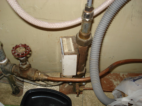

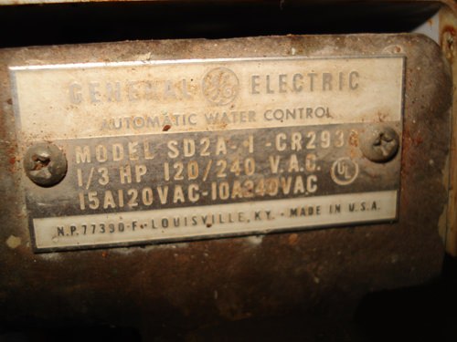

Bain Posted May 10, 2007 Report Share Posted May 10, 2007 I found it in a +/- fifty year old house. The plate merely says, "Automatic water control." The thing was wired into a 120-volt circuit beneath a kitchen sink. John Download Attachment: DSC02549a.jpg 186.48 KB Download Attachment: DSC02550a.jpg 193.82 KB Quote Link to comment Share on other sites More sharing options...
Chad Fabry Posted May 11, 2007 Report Share Posted May 11, 2007 Well system...or had one? Pressure booster pump switch? Quote Link to comment Share on other sites More sharing options...
Bain Posted May 11, 2007 Author Report Share Posted May 11, 2007 I can't know for sure, Chad, but the place was only a couple of miles from downtown, so they likely have always been on a utility-supplied water service. I actually Googled different iterations of GE and the model number and didn't get any worthwhile hits. Umm, and did I mention that I suffer severely from OCD? Quote Link to comment Share on other sites More sharing options...
hausdok Posted May 11, 2007 Report Share Posted May 11, 2007 It's time to call Schenectady and talk to somone who can look it up for you. OT - OF!!! M. Quote Link to comment Share on other sites More sharing options...
Neal Lewis Posted May 11, 2007 Report Share Posted May 11, 2007 I think Chad's got it. The rating for 1/3 horsepower is interesting. Maybe the pump part of it was located in the basement at one time? Quote Link to comment Share on other sites More sharing options...
Tom Corrigan Posted May 11, 2007 Report Share Posted May 11, 2007 This is a flow switch. It allows power to the garbage disposer only when there is water flow at the faucet. Tom Corrigan Quote Link to comment Share on other sites More sharing options...
ozofprev Posted May 11, 2007 Report Share Posted May 11, 2007 There's a garbage disposal? Well, why didn't someone say it was connected to a garbage disposal? [:-weepn] Originally posted by Tom Corrigan This is a flow switch. It allows power to the garbage disposer only when there is water flow at the faucet. Tom Corrigan Quote Link to comment Share on other sites More sharing options...
Bain Posted May 11, 2007 Author Report Share Posted May 11, 2007 I never would have guessed. Thanks, Tom. I wonder if it was still working . . . I didn't energize the disposer sans water running. Quote Link to comment Share on other sites More sharing options...
