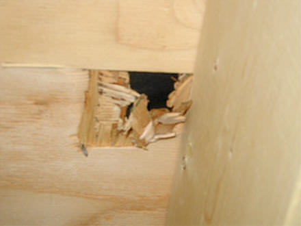

denable Posted March 11, 2004 Report Share Posted March 11, 2004 Found plywood roof sheathing damaged at three areas of a 1 year house, in one case a nail end was visible and in the other two cases the nail shot all the way through into the attic. I'm I justified in being concern that there may be a number of shingles damaged by overdriven nails? This was a two story colonial steep pitched roof so I did climb the roof. Download Attachment: sheathing2.jpg 16.15 KB Quote Link to comment Share on other sites More sharing options...
WILLIE Posted March 11, 2004 Report Share Posted March 11, 2004 Wow, that looks like a .3006 Quote Link to comment Share on other sites More sharing options...
DLRambo Posted March 11, 2004 Report Share Posted March 11, 2004 How big is the hole - it looked awful big for a nail. We see damages that look like that several times a week around the passive roof vents in an attic. I've never written them up. Quote Link to comment Share on other sites More sharing options...
denable Posted March 11, 2004 Author Report Share Posted March 11, 2004 Originally posted by DLRambo How big is the hole - it looked awful big for a nail. We see damages that look like that several times a week around the passive roof vents in an attic. I've never written them up. Dan, The damaged areas were right where the nails were driven in. You know how plywood is, if you apply a strong force in a small area it will rip out like a shotgun load going through it. Dennis Quote Link to comment Share on other sites More sharing options...
chrisprickett Posted March 11, 2004 Report Share Posted March 11, 2004 Looks to me, to resemble a "field bore": Roofer needs a hole to run his air hose to the roof, so he bashes out the plywood with his hammer. If the house is a two (or more) story, he probaly had his compressor set up on the second floor deck. I can't see a nail gun doing that. Quote Link to comment Share on other sites More sharing options...
RobC Posted March 11, 2004 Report Share Posted March 11, 2004 Dennis, I can't see a roofer doing that kind of damage especially with an air driven tool. This looks more like a 28 oz. type hole that usually belongs to a framer. If we had to speculate on the reason for it, I'd go with Chris's explanation. Did you find 'H' clips in the installation? I don't see much of a space between the sheathing. Quote Link to comment Share on other sites More sharing options...
Renron Posted March 11, 2004 Report Share Posted March 11, 2004 Dennis, After shooting over 100,000 round head nails, I can tell you this did not happen from the nail gun. Chris' explaination is the "best guess" and I'd put money on it. Never did it personally, but have seen others do stuff like that all the time. Ron Quote Link to comment Share on other sites More sharing options...
Paul MacLean Posted March 11, 2004 Report Share Posted March 11, 2004 It looks like the decking holes for vents that are "cut" with hammers around here. Quote Link to comment Share on other sites More sharing options...
denable Posted March 11, 2004 Author Report Share Posted March 11, 2004 Originally posted by RobC Dennis, I can't see a roofer doing that kind of damage especially with an air driven tool. This looks more like a 28 oz. type hole that usually belongs to a framer. If we had to speculate on the reason for it, I'd go with Chris's explanation. Did you find 'H' clips in the installation? I don't see much of a space between the sheathing. H clips, are you kidding? I find the correct spacing between OSB and plywood sheathing in about one out of 20 new houses. Dennis Quote Link to comment Share on other sites More sharing options...
