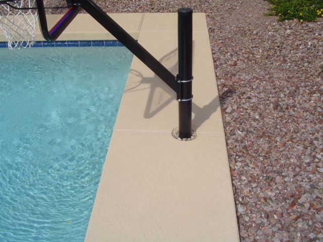

chrisprickett Posted March 11, 2004 Report Share Posted March 11, 2004 An accessory for the pool, but it could be considered portable. Does the bonding code apply? Download Attachment: bballhoop.jpg 142.68 KB Quote Link to comment Share on other sites More sharing options...
Renron Posted March 13, 2004 Report Share Posted March 13, 2004 Chris, this was stolen straight from Norm on the swimming pool forum: "NEC 680.26(B)(5) refers to all metal within 5 feet of the waterline. A metal gutter downspout would be included and, therefore, must be bonded. NORM SAGE" Just passin' it from one place to 'nother Ron Quote Link to comment Share on other sites More sharing options...
Jeff Remas Posted October 25, 2009 Report Share Posted October 25, 2009 Chris, sorry for the delay with my post but yes, it still has to be bonded, even 3 code cycles later. Quote Link to comment Share on other sites More sharing options...

sepefrio Posted October 26, 2009 Report Share Posted October 26, 2009 Just a question to clarify, does this apply to temporary objects as well as permanently installed. My experience with those nets and how this one appears, you can remove it at will (it just slides into the hole). If it was bonded, then that alone would make it permanent right? Or would the hole it slides into be grounded? Quote Link to comment Share on other sites More sharing options...
