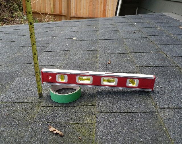

Richard Moore Posted May 8, 2009 Report Share Posted May 8, 2009 I made my own when I started to measure pitches from the ground. I stopped using it fairly quickly as I found that I could eyeball a pitch accurately enough for the report in most cases. It's here if anyone wants it (works best on gable roofs). Download Attachment: pitchgauge.pdf 69.64 KB I do use the tape and rule method for taking photos of the (relatively rare) low slope/shingle issues. Click to Enlarge 112.18 KB Quote Link to comment Share on other sites More sharing options...

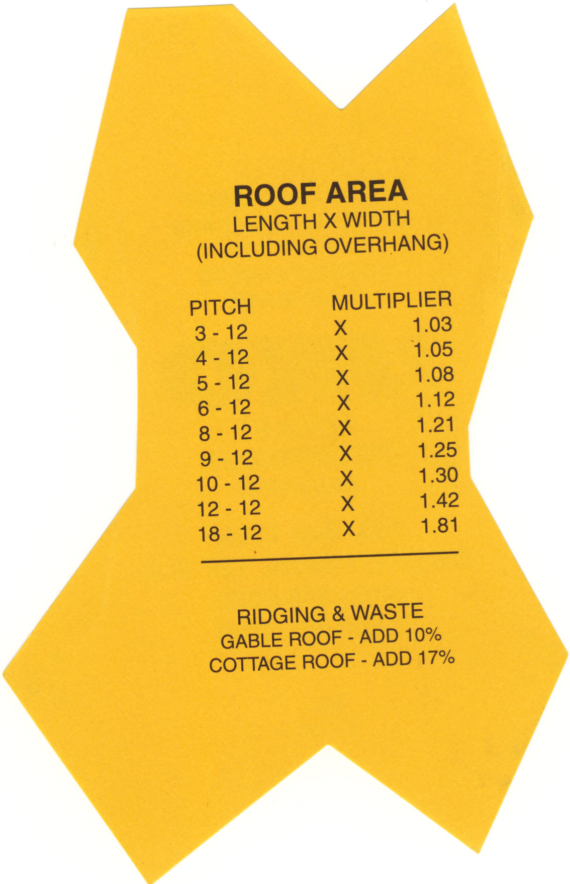

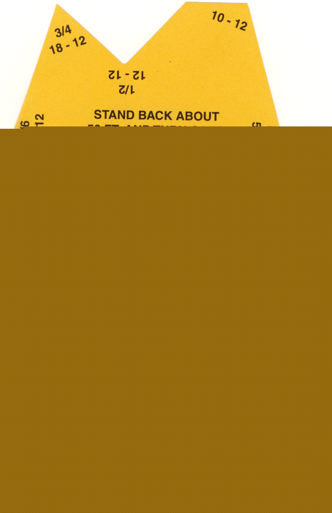

RobC Posted May 8, 2009 Report Share Posted May 8, 2009 I measure roof pitch if I suspect shingles have been installed on a less than 4:12 slope. I like to keep things simple, this is what I carry in my binder and its FREE. The amusement factor is priceless. Download Attachment: IKOPocketPitchfinder.jpg 378.44 KB Here is the other side if you want to calculate coverage. Download Attachment: IKOPocketPitchfinder2.jpg 323.71 KB Inside complex roof slopes I'll use a tape and level. Quote Link to comment Share on other sites More sharing options...
