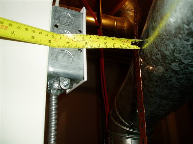

RobC Posted March 19, 2004 Report Share Posted March 19, 2004 Just had an interesting talk with the local authority regarding combustible clearances pertaining to electrical stuff. This is what I'm talking about. Download Attachment: VentClearance1_M.jpg 50.47 KB I know it won't ignite but I would think the proximity of the switch from the C' vent would make it susceptible to operating under higher temerature than designed for. I would also suggest that the plastic would become brittle over time. And possibly a chance for a burn accident to happen. Is there anything else I've missed? Dang I've forgotten ACCESS again. OK! anything else? Quote Link to comment Share on other sites More sharing options...
Terence McCann Posted March 19, 2004 Report Share Posted March 19, 2004 Hi Rob: Are those red wires in the background touching the vent? Quote Link to comment Share on other sites More sharing options...
RobC Posted March 19, 2004 Author Report Share Posted March 19, 2004 Good Eye Those are control wires and not touching. Quote Link to comment Share on other sites More sharing options...
