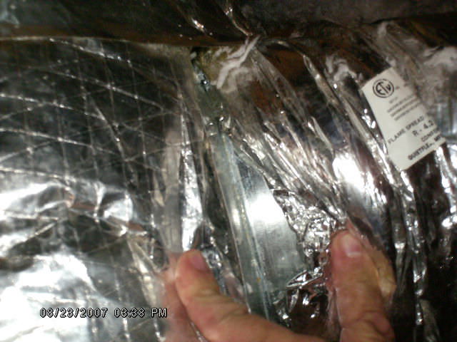

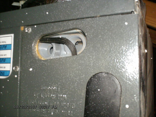

Phillip Posted August 24, 2007 Report Share Posted August 24, 2007 A waste of duct tape. Image Insert: 106.62 KB Image Insert: 92.64 KB This is a new home Of course they cannot install ductwork or Image Insert: 95.37 KB a unit. Image Insert: 110.59 KB Quote Link to comment Share on other sites More sharing options...
Bain Posted August 24, 2007 Report Share Posted August 24, 2007 I find those plastic plugs missing in evaporator coils all the time. Is there any reasonable--albeit wrong--explanation for why someone would remove one? John Quote Link to comment Share on other sites More sharing options...
hausdok Posted August 24, 2007 Report Share Posted August 24, 2007 That's where you intentionally and figuratively jack-slap the HVAC installer and builder by writing something in your report like, "Have a competent HVAC technician - not the hack who installed this system - clean this mess up." ONE TEAM - ONE FIGHT!!! Mike Quote Link to comment Share on other sites More sharing options...
Jim Katen Posted August 24, 2007 Report Share Posted August 24, 2007 Originally posted by Bain I find those plastic plugs missing in evaporator coils all the time. Is there any reasonable--albeit wrong--explanation for why someone would remove one? John The units ship with the plugs in a plastic bag. The installer has to put them in. - Jim Katen, Oregon Quote Link to comment Share on other sites More sharing options...
Bain Posted August 24, 2007 Report Share Posted August 24, 2007 Didn't know that, Jim. I suppose it's like finding the unopened bag of refrigerant-line grommets sitting on top of the unit, huh? Those are always interesting photos to show customers. John Quote Link to comment Share on other sites More sharing options...
