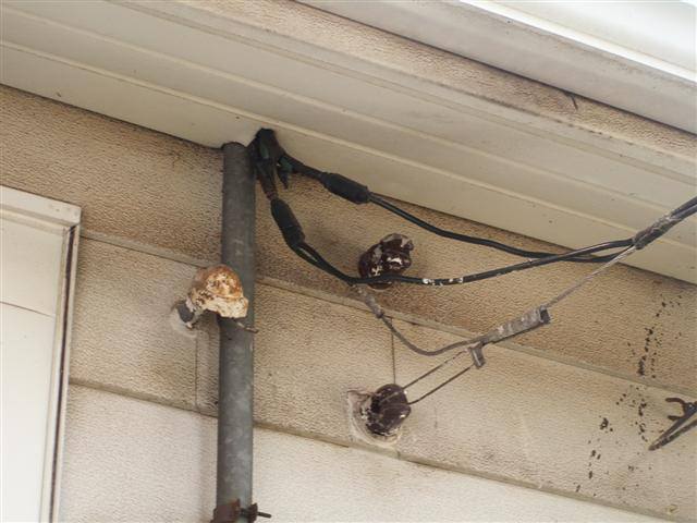

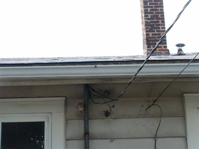

fqp25 Posted August 27, 2007 Report Share Posted August 27, 2007 Can the weather head be embedded in the soffit? I could not see anything from the attic. Image Insert: 137.77 KB Image Insert: 89.66 KB Quote Link to comment Share on other sites More sharing options...
hausdok Posted August 27, 2007 Report Share Posted August 27, 2007 It's more than likely tucked up the bottom of whoever installed that setup. OT - OF!!! M. Quote Link to comment Share on other sites More sharing options...
Bill Kibbel Posted August 27, 2007 Report Share Posted August 27, 2007 I'm sure there is something somewhere that says it's wrong. If those are operable windows flanking the service attachment, the service drop should be at least 3' away. Quote Link to comment Share on other sites More sharing options...
Brian G Posted August 27, 2007 Report Share Posted August 27, 2007 Originally posted by inspecthistoric I'm sure there is something somewhere that says it's wrong. And if there isn't, there should be. Jeez. Brian G. Don't Worry Lady, We'll Just Cut Around It [:-dunce] Quote Link to comment Share on other sites More sharing options...
InspectionConnection Posted August 27, 2007 Report Share Posted August 27, 2007 I just finished the electrical portion of my training, in which I learned that no portion of the mast is supposed to be buried by siding materials, I would assume this includes the mast head being covered by soffit materials. Quote Link to comment Share on other sites More sharing options...
John Dirks Jr Posted August 28, 2007 Report Share Posted August 28, 2007 Its also lacking a good drip loop. Quote Link to comment Share on other sites More sharing options...
fqp25 Posted August 28, 2007 Author Report Share Posted August 28, 2007 No good drip loop, 3" feet from window I got an explanation for this set-up (wasn't really looking for one but got one anyway). Apparently this area was hit pretty hard with an Ice/Wind Storm this past winter. There was a lot of damage to utility lines, and the utility companies were overwhelmed, to say the least. Anyway when they repaired the service lines to this house they had decided that the old weather head was too close to the windows. So they installed a new meter and mast, but contractor doing the repair could not touch the roof, so they just tucked the mast up in the soffit, trying to make the 3' clearance. This what the seller or his realtor just e-mailed me. Emergency or not it's still not right. I just call it as I see it. Quote Link to comment Share on other sites More sharing options...
hausdok Posted August 28, 2007 Report Share Posted August 28, 2007 Hi, I wouldn't call the drip loop. The conductors droop downward from the weatherhead before they climb to the pole. That's what a drip loop does. There's enough slope there to ensure water can't go up those wires into the masthead. I think the explanation is a crock. That looks like it's been there for years. ONE TEAM - ONE FIGHT!!! Mike Quote Link to comment Share on other sites More sharing options...
fqp25 Posted August 28, 2007 Author Report Share Posted August 28, 2007 Originally posted by hausdok That looks like it's been there for years. I agree. Quote Link to comment Share on other sites More sharing options...
Kyle Kubs Posted August 28, 2007 Report Share Posted August 28, 2007 Questionable? Personally I'm voting for Laughable. But I'm not laughing, just sitting here shaking my head... Bill, Think of it this way; If a cop sees a guy drive by with a car load of penguins, he probably can't think of a specific statute that makes it wrong... but he know's damn well it's time to hit the lights. [:-slaphap Quote Link to comment Share on other sites More sharing options...
