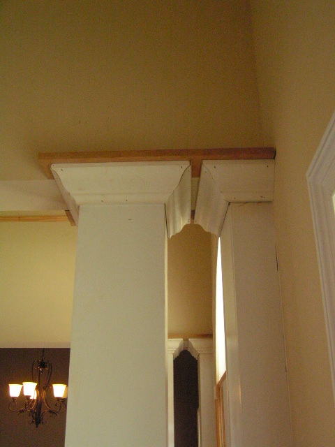

Jim Baird Posted September 17, 2007 Author Report Share Posted September 17, 2007 You guys are so generous with your attention. I try to leave the cosmetics up to the buyer, who usually is way more focused on that category. Take a look at the pic below. Think it should be cause for concern? Image Insert: 217.51 KB Quote Link to comment Share on other sites More sharing options...
hausdok Posted September 17, 2007 Report Share Posted September 17, 2007 If that's the final finished and painted product, the builder and the trim carpenter should both be taken out and flogged. OT - OF!!! M. Quote Link to comment Share on other sites More sharing options...
SonOfSwamp Posted September 17, 2007 Report Share Posted September 17, 2007 FWIW, there are some, well, guidelines in the NAHB Residential Construction Performance Guidelines. Stuff like certain cosmetic defects must be fixed if they're visible from a certain distance. I've cited those guidelines a few times. Truth be told, the house can look like hell and still meet the NAHB guidelines. But that can be good: it sets customer expectations exactly where they should be, which is very, very low. WJ Quote Link to comment Share on other sites More sharing options...
Jim Katen Posted September 17, 2007 Report Share Posted September 17, 2007 Originally posted by hausdok If that's the final finished and painted product, the builder and the trim carpenter should both be taken out and flogged. OT - OF!!! M. Nah, they'll goop it up, spray on 1/8" of paint and call it good. - Jim Katen, Oregon Quote Link to comment Share on other sites More sharing options...
