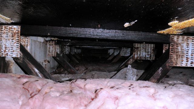

willlong Posted October 6, 2010 Report Share Posted October 6, 2010 Well, it's started. Did and inspection (maintenance) yesterday. Was called in by a contractor, but the owner and architect was there. 20 year old SFH with 3 stories and a penthouse in the middle of the roof with roof decks at front and back.The owner had bought the place 3 months ago (the poor guy). Owner complained of possible water intrusion. Crown moulding was deformed. Did thermal and the roof joists were not normal. Protometer pegged out at the trusses. The contractor open the ceiling and the trusses and roof deck were rotted (black, mold, sopping fiberglass insulation, no vapor barrier, the usual crap. The only fix is to gut the top floor, replace the roof, trusses, etc. Click to Enlarge 39.57 KB Click to Enlarge 45.68 KB Quote Link to comment Share on other sites More sharing options...
willlong Posted October 6, 2010 Report Share Posted October 6, 2010 I would add that the main structural problem is that the grout the trusses to the block. Pardon me if I am misinformed, but I was taught that wooden joists and trusses should never be in direct contact with masonry. I fear structural failures with pancake collapses this winter, when the snow load occurs. One other point. Who is the idiot who insists that there should be plastic sheeting behind the drywall? That just serves to create an aquafer. Hope this helps; Quote Link to comment Share on other sites More sharing options...
