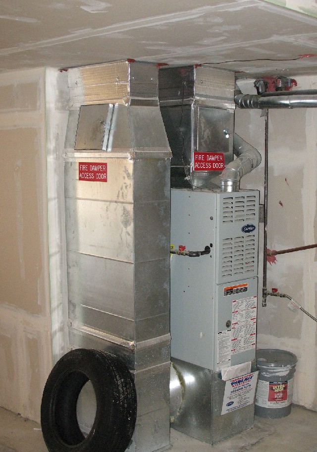

Richard Moore Posted October 14, 2007 Report Share Posted October 14, 2007 Large townhouse complex built in 2001. My unit was a 3 story, mid block unit with a tandem garage occupying almost the entire lower level. Furnace was a very normal Carrier 80% induced draft model. Both the return and supply plenums had fire dampers installed. I presume the purpose of these is to stop the spread of smoke (and flames?) from a fire in the garage, and I have no problem with them being there. The flaps inside were open, and while I'm not clear on the "triggering" mechanism I would assume it's heat? But...I've done countless similar townhomes, many from the same era and in the same jurisdiction, and I've never seen these installed before. Actually, never seen them in any residence. I guess I'm not used to builders installing extra safety devices unless they are forced to. So my question is...Is there any reason these might be "required" in a particular complex or unit? Download Attachment: firedampers.jpg 158.03 KB Quote Link to comment Share on other sites More sharing options...
Phillip Posted October 15, 2007 Report Share Posted October 15, 2007 I don't know why they where install when other in that areas does not have them. Unless it some insurance company or owned by the state. In most of the fire damper there is what is called a fire links that part of the strap that hold the blades open. I would like to know which set up of blades is inside the damper. Was it blades that folded up into the side or a hat or did it have two blades that has fire proof drywall on them that open up to the center like a set of doors? Quote Link to comment Share on other sites More sharing options...
Darren Posted October 15, 2007 Report Share Posted October 15, 2007 The fire damper was probably installed with a melt-link connection; some also come with an electrically charged link tied to the fire alarm. For that damper to be properly installed, it should be even with the drywall ceiling; not any lower. This way there is a continious line of 'seperation' . Actually, I see that quite often here in NJ. I always open the access door and show my clients the damper & link; I also advise them if the damper closes, there will be no heat or cooling. There is one condo development here (in Whippany) where the ducts are in the (fire seperation) ceiling that has these dampers at each register and I do believe on one inspection 2 or 3 were closed. Darren www.aboutthehouseinspections.com Quote Link to comment Share on other sites More sharing options...

hausdok Posted January 6, 2009 Report Share Posted January 6, 2009 Hi Rich, I haven't a clue. Out of somewhere around 4500 inpsections with about 90% of them with furnaces in the garage I've only seen about 3 or 4 setups like that. As I recall, the last one had a laundry room in the back of the townhome garage and there was a heat duct into the laundry room. In my mind, that was the reason for the damper. Anything like that there? ONE TEAM - ONE FIGHT!!! Mike Quote Link to comment Share on other sites More sharing options...
energy star Posted January 6, 2009 Report Share Posted January 6, 2009 One of my firsts tasks at a new job was to go up into an attic (Dover NJ) and remove the 140 degree links and replace withe 160 degree. The 140's were melting from the heat in the attic. HOT! Quote Link to comment Share on other sites More sharing options...
steve morris Posted January 16, 2009 Report Share Posted January 16, 2009 The dampiers in the duct have fuse links aprox. 160 is the temp. they trip at. When you have a rated ceiling, where the grills are on the surface, the dampiers must be a "CEILING RADIATION DAMPIER" they are different. If you can access them enough, they have a small tag on them telling you the hour rating,(1.5 to 3 hr.), the mfg. of the dampier, and who is the testing/listing agency. The have very specific mounting instructions. Several web sites can give you lots of info.(MIAMI TECH.,LLOYDS, RUSKINS all have their instructions and general info on them). ON another note the pics. you sent, the duct work dosen't seem to be sealed at the joints. If this is a garage, this is very important due to carbon monoxide. Here in Gainesville, FL. we hade a death due to a car left running(accident)in the garage, The old man was inside the house, with the a/c running. The return air had many joints in the duct none sealed.. This is part of our bldg. code and energy code. Quote Link to comment Share on other sites More sharing options...
steve morris Posted January 16, 2009 Report Share Posted January 16, 2009 After looking at the picture again if the red color on the corners of the angles around the dampiers is fire caulk make note of it per most mfgs. no fire caulk is allowed, some of the fire caulk is intersermesent(probely spelled wrong) this means when in a fire it will swell up several times it's size to seal the hole. Quote Link to comment Share on other sites More sharing options...
Erby Posted January 17, 2009 Report Share Posted January 17, 2009 You're "Probely" right![][][] I think you're looking for "intumescent", a property of a substance which swells when heated. http://en.wikipedia.org/wiki/Intumescent Quote Link to comment Share on other sites More sharing options...
energy star Posted January 17, 2009 Report Share Posted January 17, 2009 I will not install a unit in a garage. Those dampers are in a 16 gauge sleeves inside the ductwork and then mechanically fastened. The fire caulk will not be in the way of the damper. I do agree with you about sealing the duct work. The duct does have tape on the connections (Not the best) but the unit itself has so many air leaks its hard to seal them all. Quote Link to comment Share on other sites More sharing options...
