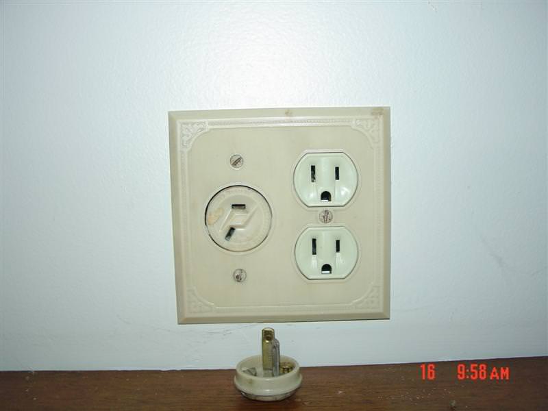

Les Posted October 16, 2007 Report Share Posted October 16, 2007 House is 1932, brick veneer, 2 1/2 storey, 30amp service entrance. There are one of these outlets in every room, except baths and kitchen. All are stand alone, except the one over the fireplace. No power in any of them. Most have the plug inserted with no cord attached. Just when I was beginning to think I knew everything! Throwing in the water pump and water heater for good measure and entertainment - Image Insert: 38.05 KB Image Insert: 37.29 KB Image Insert: 38.76 KB Image Insert: 61.48 KB Image Insert: 64.45 KB Quote Link to comment Share on other sites More sharing options...

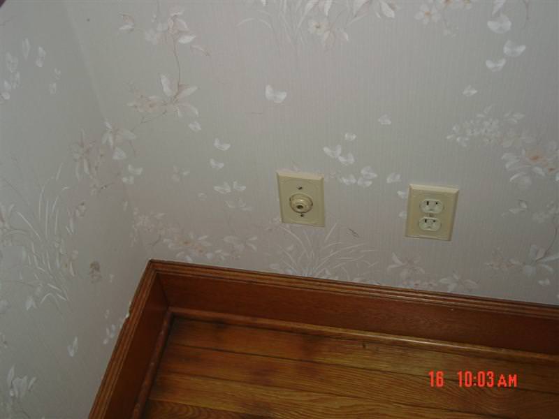

Richard Moore Posted October 16, 2007 Report Share Posted October 16, 2007 Les...was there metal or continuity between the prongs in the plug? The only thing I can think of is that they "switch" on the adjoining receptacles (or used to). In that case, you wouldn't measure any current between the two holes unless there was actually something plugged in, and turned on, at the receptacle. Very odd! Ok...just looked closer at the 3rd photo and saw the hole in the plug. Scratch all the above! [:-dunce] I'd now guess for lamp cords but no idea why the weird pattern. Quote Link to comment Share on other sites More sharing options...

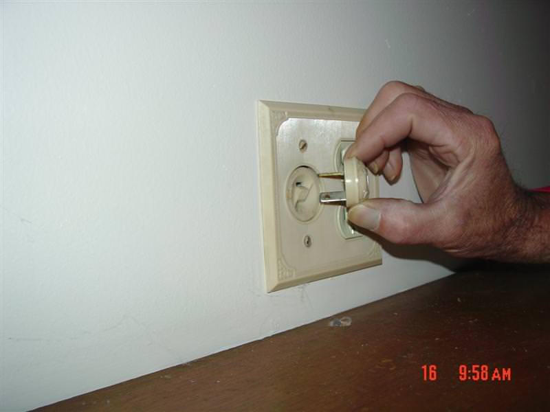

Les Posted October 16, 2007 Author Report Share Posted October 16, 2007 No, no continuity. Plug cap would accomodate an 18ga lampcord, one steel blade and one brass, both same size, folded stock. I did not remove any wall covers, as the real estate agent was a @#*@$%^ and "don't touch anything, I will ask my inspector. Does he know you?, maybe he will call and let you know what it is." I did good and managed to stop the bleeding from biting my tongue, but I do have a headache! I just have never seen anything like it. Quote Link to comment Share on other sites More sharing options...
Richard Moore Posted October 16, 2007 Report Share Posted October 16, 2007 Perhaps they were "shaped" that way to designate a switched circuit for plug in lamps. Just another WAG! Quote Link to comment Share on other sites More sharing options...
msteger Posted October 16, 2007 Report Share Posted October 16, 2007 You didn't say if there was any voltage at this odd-shaped receptacle (photos 1 and 2)? I've never seen the sort of receptacle in your photo, but it is a little curious.. Quote Link to comment Share on other sites More sharing options...
Les Posted October 16, 2007 Author Report Share Posted October 16, 2007 Matthew, no voltage. Just spend the better part of an hour tracking down a Baker Lite electric plug on-line. RESULT: The author really meant bakelite - I just love the world wide web! Where is Katen, Kurt M and Bill K when I need them! Quote Link to comment Share on other sites More sharing options...

Richard Moore Posted October 16, 2007 Report Share Posted October 16, 2007 "Plug cap would accomodate an 18ga lampcord, one steel blade and one brass, both same size..." One last guess: The different materials are interesting, and kind of "modern". Perhaps someone worked out the dangers of reversed polarity (power to shell, not switch, etc) and what we have here is America's very first polarized plug? I would imagine the receptacles and "DIY" plugs were sold as sets. Obviously, I had the day off and I'm bored! Quote Link to comment Share on other sites More sharing options...

Les Posted October 17, 2007 Author Report Share Posted October 17, 2007 I picked the lock on that repo house where the plug and socket is. Pulled cover and it is connected to cloth covered copper wire approx 16ga solid, tinned ends. They are not energized. House had a 30amp service entrance drop from pole and a 60amp main. House was custom built for a local merchant with two main entrances. Full maple floors everywhere, low fire brick exterior, rumsford stove, galley kitchen, popular trims, oak staircase, re-cycled steel I beam with steam pipe supports, no cistern, block foundation, all head room clearances were low with standard single panel doors. The roof is original 1932 slate asbestos shingle and functional. Typical modified four square floor plan. 1 and 1/2 bathrooms with razor blade receptacles. Crane tub and Briggs pedestal sink. I am running out of time with my reputation of knowing "everything". As most of you know, I have a pretty good library of old books and publications and have found nothing. I had the office staff go thru everything and still nothing. Will keep you posted and keep the ideas coming! Quote Link to comment Share on other sites More sharing options...

Les Posted October 19, 2007 Author Report Share Posted October 19, 2007 Douglas H has come to the rescue again!! The device is for radio antennae connection. While he has only seen those that have power, I am going back to house, legally this time, and going to track the wires. Also, if you look at this new larger photo you can see it embossed with "Aerial" on the top and "grounding" at the bottom of the socket. Will keep you posted. Download Attachment: DSC000411.JPG 38.03 KB Quote Link to comment Share on other sites More sharing options...
hausdok Posted October 19, 2007 Report Share Posted October 19, 2007 That makes sense, When I was a kid radios all had some kind of antennae lead or connection point. I suppose at some point prior to television folks could have had their homes pre-wired with an antenna (aerial) system. It also makes sense that it would be a plug that couldn't possibly be confused with a conventional current-carrying type. Bet if you cruise some vintage radio websites you'll eventually find a picture of an old radio with a cord and plug attached. OT - OF!!! M. Quote Link to comment Share on other sites More sharing options...
