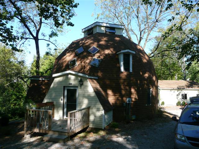

Mark P Posted October 26, 2007 Report Share Posted October 26, 2007 I recommened they monitor the heavens to see if they are returning for the escape pod. Image Insert: 94.8 KB Quote Link to comment Share on other sites More sharing options...
