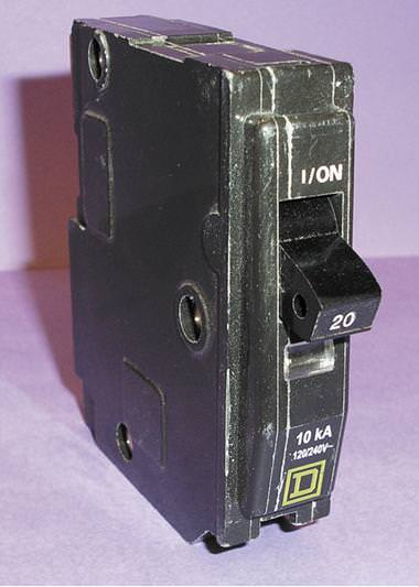

AHI in AR Posted October 31, 2007 Report Share Posted October 31, 2007 Washington, D.C./October 30, 2007 - Release #08-0583 The U.S. Consumer Product Safety Commission, in cooperation with Connecticut Electric & Switch Mfg. Co. (Connecticut Electric), of Puyallup, Wash., today announced a voluntary recall of approximately 64,000 circuit breakers that are counterfeit and could fail to trip when they are required to, posing a fire hazard to consumers. The counterfeit circuit breakers are black, were made in china, and are marked as Square D products. They were sold through electrical Distributors and hardware stores nationwide from February 2005 through August 2006 for between about $6.50 and $15.50. Connecticut Electric has identified the following breakers as possibly being counterfeit: QO115, QO120, QO140, QO2125, QO215, QO220, QO230, QO240, QO250, QO260, QO1515, QO2020, QO3100, QO320, QO330, QO340, QO360, QOB120, QOB130, QOB220, QOB230, QOB250, QOB330, and QOB360. Actual Square D circuit breakers have (a) the amp rating written on the handle in white paint on the front of the breaker; (b) the Square D insignia molded onto the breaker side, and; © a yellow chromate mounting clip with half of the top of the clip visible. If your Square D breaker does not match this description, it could be counterfeit. Inspectors finding these breakers should advise homeowners to contact Connecticut Electric to determine if the breaker they have is counterfeit and if necessary, to arrange for a free inspection and replacement or refund. For more information, contact Connecticut Electric at (866) 264-3702 from 8 a.m. to 5 p.m. ET Monday through Friday or visit the companyââ¬â¢s Web site at www.connecticut-electric.com. Consumers also can obtain additional information by emailing Connecticut Electric at bdunham@connecticut-electric.com. To see this recall on CPSC's web site, including pictures of the recalled products, please click here. The U.S. Consumer Product Safety Commission is charged with protecting the public from unreasonable risks of serious injury or death from more than 15,000 types of consumer products under the agency's jurisdiction. Deaths, injuries and property damage from consumer product incidents cost the nation more than $700 billion annually. The CPSC is committed to protecting consumers and families from products that pose a fire, electrical, chemical, or mechanical hazard or can injure children. The CPSC's work to ensure the safety of consumer products - such as toys, cribs, power tools, cigarette lighters, and household chemicals - contributed significantly to the 30 percent decline in the rate of deaths and injuries associated with consumer products over the past 30 years. Quote Link to comment Share on other sites More sharing options...

randynavarro Posted November 5, 2007 Report Share Posted November 5, 2007 According to the verbal description of a real Square D breaker and the photo of the counterfeit, there's no way to tell them apart unless you find the Square D. insignia molded on to the side. Am I comprehending this correctly? So, unless I choose to pull each breaker, I won't be able to tell the counterfeit from the real one. Quote Link to comment Share on other sites More sharing options...
Jim Katen Posted November 5, 2007 Report Share Posted November 5, 2007 The picture in the original post (and on the CPSC web site) is of a legitimate Square D breaker. It would be nice if the trolls at the CPSC would post a picture of one of the fake breakers alongside the real one. - Jim Katen, Oregon Quote Link to comment Share on other sites More sharing options...
hausdok Posted November 6, 2007 Report Share Posted November 6, 2007 I inferred (perhaps wrongly) from the announcement that the bogus breakers are all black and don't have the amperage rating on the face of the toggle like the one in the picture. If I remember it, I'll call CPSC in the morning and see if I can get some more information. OT - OF!!! M. Quote Link to comment Share on other sites More sharing options...

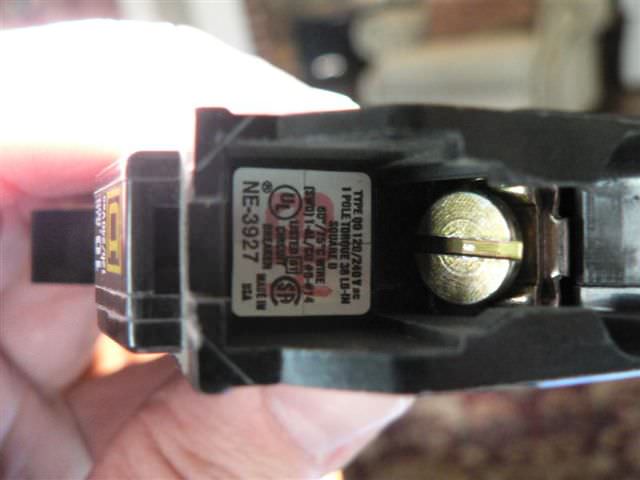

hausdok Posted November 7, 2007 Report Share Posted November 7, 2007 Hi, I just got off the phone with Connecticut-Electric's POC on this issue. Spotting these isn't going to be easy because Square D only gave them the information to describe a legitimate Square D breaker and didn't share information about the tell tales on the counterfeit ones. He says that, without taking the breakers out, one should look for: 1. Only QO model breakers and not any others such as the Homeline series, etc. 2. The amperate numbers are painted in white paint on the end of the toggle. 3. When the breaker is installed the UL sticker is supposed to be upside down when the toggle is above but on the counterfeits it is rightside up. (Looking at the picture, this one has me scratching my head.) 4. The yellow tinge on the top of the chromate mounting clip. He explained that they'd contacted all of their dealers before these got out onto the market, but they have no way of knowing whether other distributors have released any counterfeit breakers. You guys can take solace in the fact that the information being put out about the counterfeits is sufficiently ambiguous that it's probably doubtful that anyone in this business could ever be blamed for missing one of the counterfeit breakers. ONE TEAM - ONE FIGHT!!! Mike Quote Link to comment Share on other sites More sharing options...

Neal Lewis Posted November 7, 2007 Report Share Posted November 7, 2007 Mike, The UL label is next to the terminal screw/plate. Image Insert: 52.91 KB Quote Link to comment Share on other sites More sharing options...
