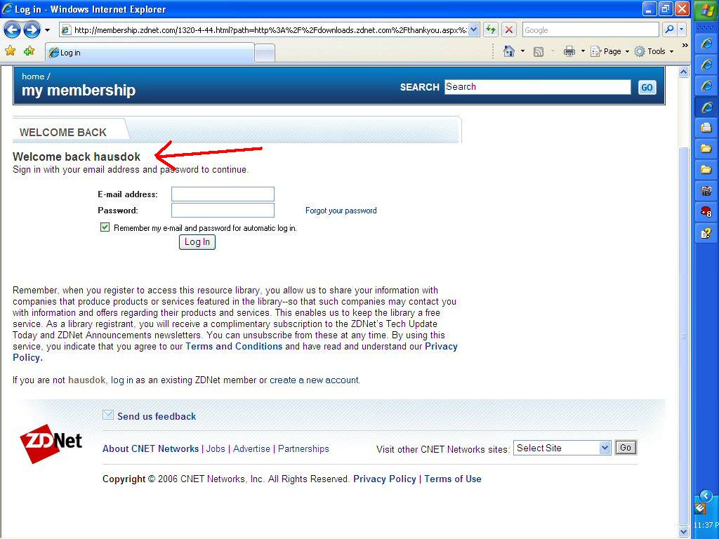

Inspectorjoe Posted November 1, 2007 Report Share Posted November 1, 2007 Originally posted by homnspector ZD net has free drawing programs for roof diagrams, etc. This is one I have used in the past, it's pretty easy and can be imported into the report like a photo: http://downloads.zdnet.com/download.asp ... cid=227363 I clicked on the link and found something strange. I found that Mike must have been using my computer! Download Attachment: Screen.jpg 130.56 KB Quote Link to comment Share on other sites More sharing options...
hausdok Posted November 1, 2007 Report Share Posted November 1, 2007 Well, either that or you've been masquerading as me! Gess I godda kaul shikago an get Shikago Kurt to send da boyz too Pennsylvany and have a wurd wit yous. OT - OF!!! M. Quote Link to comment Share on other sites More sharing options...
