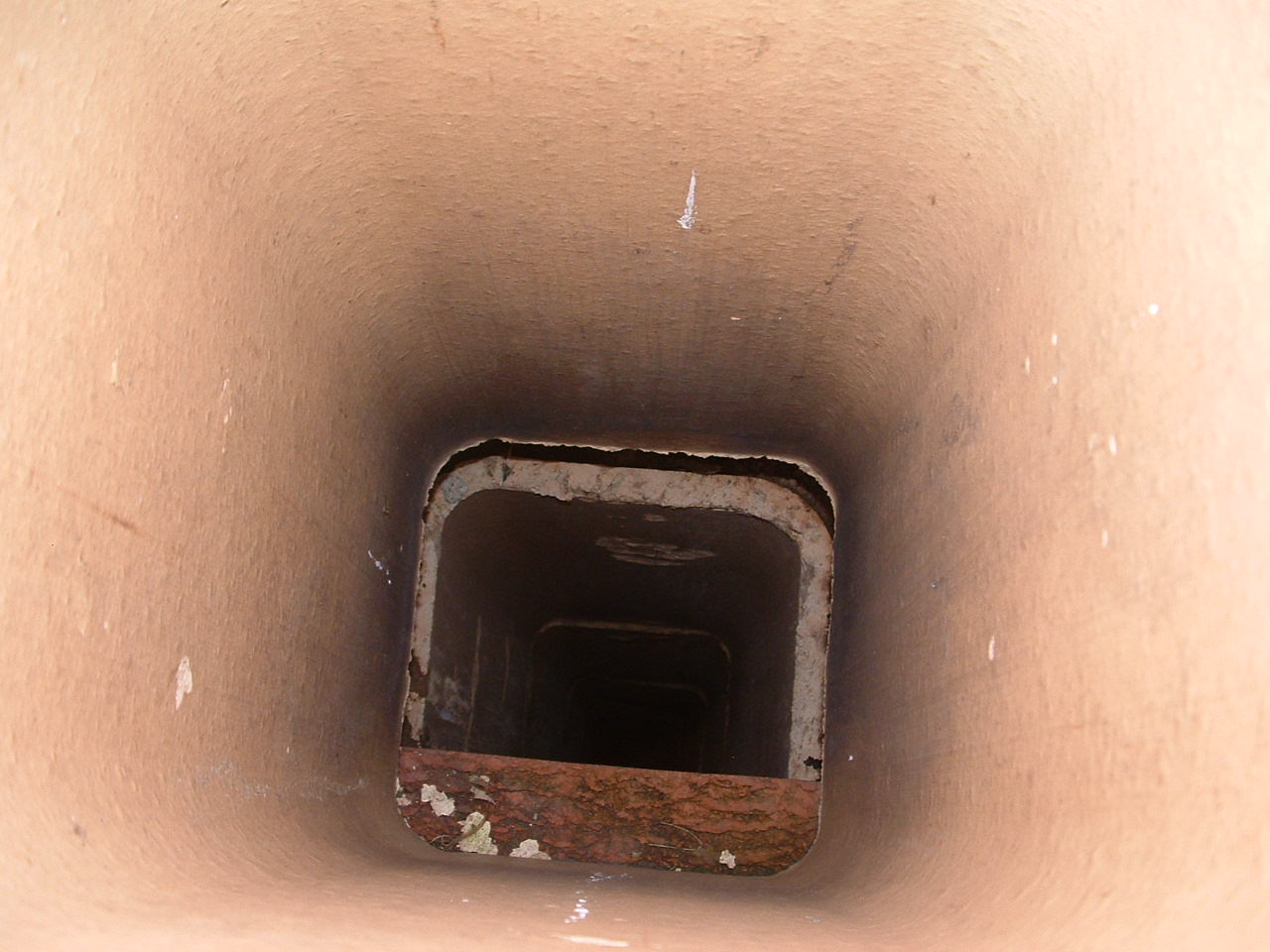

Chad Fabry Posted November 1, 2007 Report Share Posted November 1, 2007 The top terra cotta liner section in this masonry stack was about three inches above the section below. There's a brick for a spacer you can see in the photo. Think the mason just ran out of liner sections? Image Insert: 335.59 KB Quote Link to comment Share on other sites More sharing options...
John Dirks Jr Posted November 1, 2007 Report Share Posted November 1, 2007 Would that defect be what is causing the stains to collect at that point? From turbulance caused by the offset? Quote Link to comment Share on other sites More sharing options...
Brad Manor Posted November 1, 2007 Report Share Posted November 1, 2007 I see it once in a while, I think that it's just easier to do it like that than to cut a piece of liner to the right size (no one's gonna look, right?). Most of the time I see it, the top section is sitting on nails, at least your guy used a brick. -Brad Quote Link to comment Share on other sites More sharing options...
Bill Kibbel Posted November 1, 2007 Report Share Posted November 1, 2007 Originally posted by Chad Fabry Think the mason just ran out of liner sections? No. It's done that way to avoid the horror of actually going to the truck to get the saw and cutting one piece. It's wrong, but very common. Quote Link to comment Share on other sites More sharing options...
Terence McCann Posted November 1, 2007 Report Share Posted November 1, 2007 A few questions then: Has the flue gas eaten away any of the mortar/brick where the gap in the lining is? What do you guys write when you find it? Do you recommend repair? Does anyone have a picture of something Bill hasn't seen? Quote Link to comment Share on other sites More sharing options...
Chad Fabry Posted November 1, 2007 Author Report Share Posted November 1, 2007 Image Insert: 105.02 KB Counting downward from the bottom of the bottom of the corbel, courses 5,6,7,8 are far more degraded than the rest of the chimney. There is a lot of efflorescence on the sides of the chimney. Quote Link to comment Share on other sites More sharing options...

msteger Posted November 10, 2007 Report Share Posted November 10, 2007 Originally posted by Chad Fabry The top terra cotta liner section in this masonry stack was about three inches above the section below. There's a brick for a spacer you can see in the photo. Think the mason just ran out of liner sections? Image Insert: 335.59 KB Who knows.. but certainly call it out for Level 2 clean/service. Recommend a chimney sweep check out what else is going on down there. Quote Link to comment Share on other sites More sharing options...
