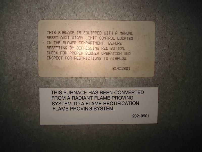

Bain Posted November 2, 2007 Report Share Posted November 2, 2007 I saw this sticker on a gas furnace earlier today and had no clue what it meant. I thought it may have something to do with a conversion to propane, but there was a natural-gas meter outside. Does anyone know what this means? Was the pilot light replaced with an electronic ignition? John Image Insert: 67.8 KB Quote Link to comment Share on other sites More sharing options...
Bill Kibbel Posted November 2, 2007 Report Share Posted November 2, 2007 Originally posted by Bain[br Does anyone know what this means? Was the pilot light replaced with an electronic ignition? They are both safety devices that sense a flame and shut down the gas valve, if the flame is not present. I'm not sure how it works, but a "radiant flame proving system" was the subject of failures and a recall for at least 1 manufacturer. A "flame rectification proving system", uses an electrical current to detect the presence of a continuous flame. This was probably a replacement part for the original, problematic radiant proving system. Quote Link to comment Share on other sites More sharing options...
