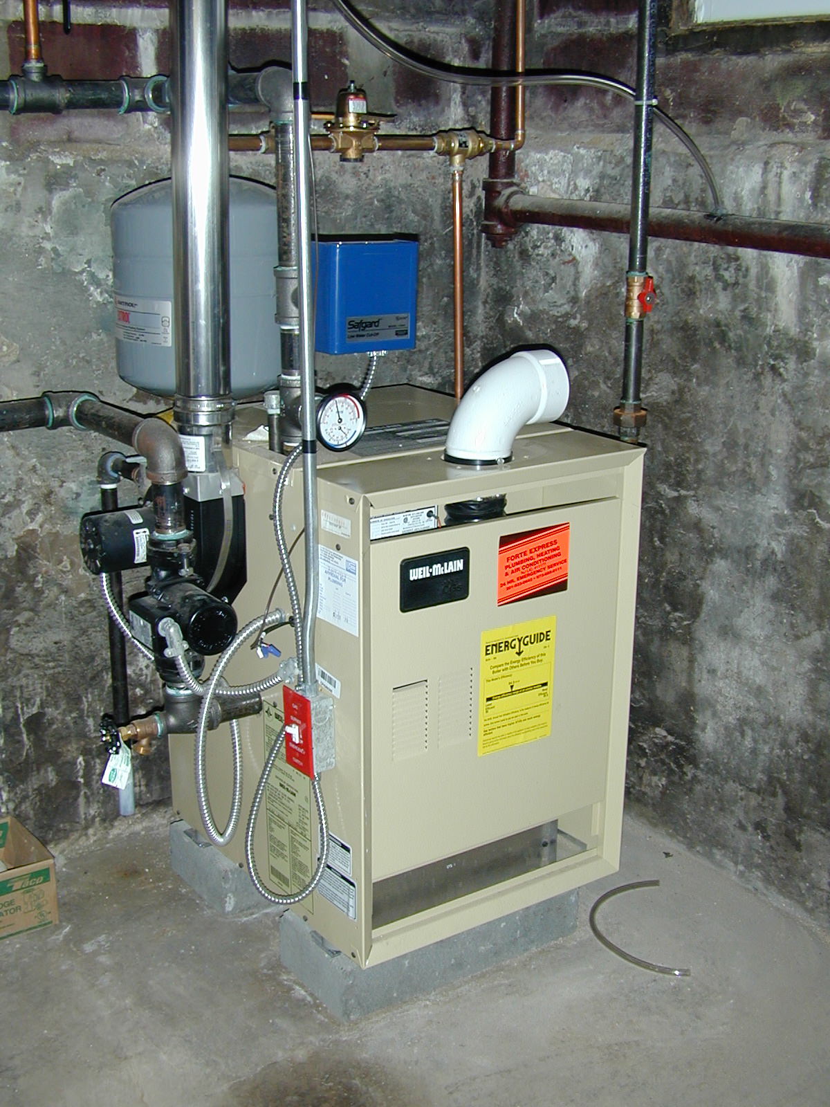

StevenT Posted November 19, 2007 Report Share Posted November 19, 2007 I'm guessing it is some condensation drain. I'm not sure if is homemade or supposed to be there. In my memory, I think I've seen drains on fan assisted systems, but they didn't look homemade. Image Insert: 61.12 KB Image Insert: 58.99 KB Image Insert: 53.16 KB Quote Link to comment Share on other sites More sharing options...
kurt Posted November 19, 2007 Report Share Posted November 19, 2007 That looks homemade to me. Where does the vent go, i.e., does it extend to the exterior for any appreciable length? Quote Link to comment Share on other sites More sharing options...
StevenT Posted November 19, 2007 Author Report Share Posted November 19, 2007 The outlet is very close. About 3' rise and 3' out. All stainless steel. I do notice the pitch of the pipe coming out ofthe boiler to be a wee bit negetive. I'm wondering if condensation has been a problem. Now that I think about it, the outer pipe is not cut or capped. Perhaps rainwater is/was a problem? Image Insert: 43.64 KB Quote Link to comment Share on other sites More sharing options...
Neal Lewis Posted November 19, 2007 Report Share Posted November 19, 2007 The vent is under pressure and is supposed to have an air tight seal. That's not possible with a hole in the pipe. Quote Link to comment Share on other sites More sharing options...
StevenT Posted November 19, 2007 Author Report Share Posted November 19, 2007 Neal, I agree. I was just wondering if there may have been a legitimate reason to install this ... plug??? As I stated, I recall a drainable "t" fitting that allowed condensation to drain. But the horizontal run was much greater than this one. I thought there was a possibility that this could be an "acceptable field fix" and not a "bogus band-aid." Quote Link to comment Share on other sites More sharing options...

Neal Lewis Posted November 19, 2007 Report Share Posted November 19, 2007 http://www.protechinfo.com/fasnseal.html Page 6 of the catalogue is a vent section with a condensate drain. I doubt that field alteration is acceptable. Quote Link to comment Share on other sites More sharing options...
kurt Posted November 19, 2007 Report Share Posted November 19, 2007 Neal, thanks for the link. Quote Link to comment Share on other sites More sharing options...
StevenT Posted November 19, 2007 Author Report Share Posted November 19, 2007 Thanks Neal, so it turns out the "plug" is a "bogus band-aid" Quote Link to comment Share on other sites More sharing options...

Kyle Kubs Posted November 22, 2007 Report Share Posted November 22, 2007 Even though it is not a condensing boiler it does have a propensity to produce condensate in the exhaust stream and a provision to drain it before it runs down and rots the heat exhanger is required by many manufacturers. What you have is a Jackasses version of the listed fitting that should be there. It has to be a horizontal drain T, the whole section of pipe is shaped to catch condensate running back in the pipe. Download Attachment: WM_cgiboilermanual.pdf 143.29 KB This is what should be there. Image Insert: 747.7 KB However I would not recommend following the example of this particular jackass in the way he decided to drain the condensate. Image Insert: 846.66 KB Oddly enough the city inspector did not see anything wrong with connecting a source of methane gas (the sewer drain line on the right) to the combustion chamber of this boiler... (we had a few words over this one) Just two weeks ago I was on a site monitoring the install of 3 similar boilers in a multifamily. Really long exhaust runs, no drain T. I mentioned it to the plumber who responded "this is not a condensing boiler, we do all of them like this" I asked him, if there is no issue with condensate, then why is the vent required to be Stainless Steel... He got a blank look on his face, then I showed him the page in the manual. He wasn't happy. Quote Link to comment Share on other sites More sharing options...
StevenT Posted November 22, 2007 Author Report Share Posted November 22, 2007 Thank you very much Kyle, I hope you do not mind if I include your picture in my report. Are you telling me that in the boiler installation above, the condensate drain line it draining into a a gas line??? I realize that sometimes people do things wrong, but I just don't see why anyone would even consider doing that? Quote Link to comment Share on other sites More sharing options...
randynavarro Posted November 22, 2007 Report Share Posted November 22, 2007 Originally posted by StevenT . . . Are you telling me that in the boiler installation above, the condensate drain line it draining into a a gas line??? No. The explosive part of poo and sewage is methane. (Wonder if the methane actually comes from the pee or the poo?) Quote Link to comment Share on other sites More sharing options...
Kyle Kubs Posted November 22, 2007 Report Share Posted November 22, 2007 Steven, Help yourself to the picture. If you want a generic version you can look up "z-vent" one of the manufacturers of this type of vent pipe. http://www.novaflex.com/productcart/pc/ ... roduct=418 The one I posted was not vented to a gas line per-say but to a plumbing waste drain pipe (source of Sewer gas which of course contains a fair percentage of methane gas) The drain line needs to have a trap on it to act as a seal. I'd imagine the one you pictured must have been venting exhaust gases through that nipple without a traped drain on it. Also, note in the manufacturers manual that I posted the drain is required to be a high temp Silicone tubing for the first 18 inches (not the clear, flamable vinyl my jackass friend used) Quote Link to comment Share on other sites More sharing options...
