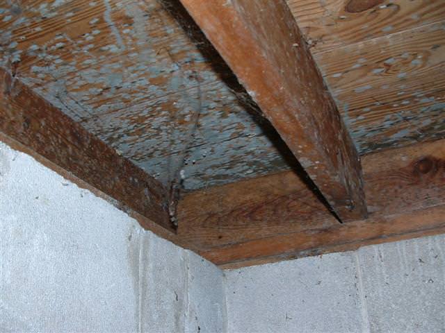

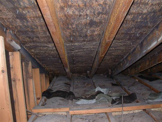

Chad Fabry Posted April 2, 2004 Report Share Posted April 2, 2004 I'm really just practicing posting pics, but here are a few from my last inspection. If anyone has something to say about the flue arrangement, I'd be interested. Induced draft gas furnce, natural draft water heater. Download Attachment: atticmold.jpg 60.66 KB Download Attachment: flue1.jpg 57.22 KB Download Attachment: moldystuff1.jpg 56.96 KB Download Attachment: panel.jpg 66.87 KB Download Attachment: splice.jpg 48.5 KB Download Attachment: stormnails.jpg 36.08 KB Quote Link to comment Share on other sites More sharing options...
Robert E Lee Posted April 2, 2004 Report Share Posted April 2, 2004 The "attic mold" looks like repeated frost build up and melting on the underside of the roof decking due to inadequate ventilation and or insulation. The "Tee" in the vent line needs a permanent seal at the base, appears to held in place by duct tape. Was there a rain cap at the top of the vent line, there looks to be mineral deposits on the joints and bottom of the pipe? Lots of double taps on the panel, but the #12 doubled up with the #6 needs some attention. Quote Link to comment Share on other sites More sharing options...
Chad Fabry Posted April 2, 2004 Author Report Share Posted April 2, 2004 Robert, The duct tape was the seal. The attic had 6 12x12 vents, unfortunately none of them had rain caps so theye were really 6 12x12 holes. Two vents were missing completely. The stuff on the sheathing was a mix of the frost residues..(there was only three inches of insulation) and mold. The number 12 double tap was feeding a 60 amp subpanel for the dryer. No ground what so ever was installed. I'm ineterested in the flue configuration, with the furnace exhaust dumping into the horizontal run. Any thoughts? Quote Link to comment Share on other sites More sharing options...
