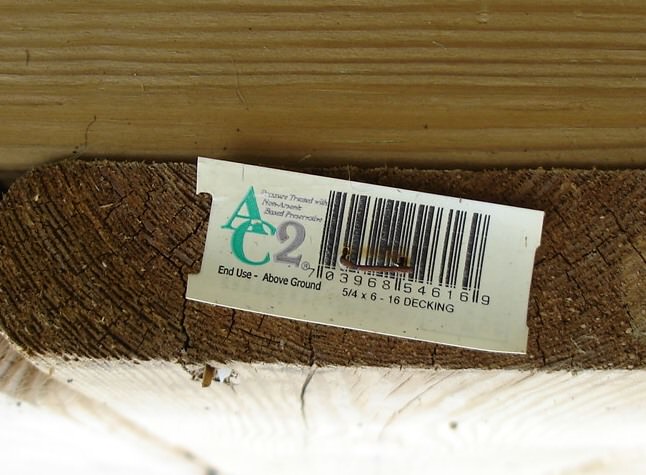

Eric B Posted November 21, 2007 Report Share Posted November 21, 2007 I will look for some ID on the lumber for ACQ info, then I check for the "Z" designation on the hangers. From what I understand, you can't make the distinctions without the tags or imprints Image Insert: 94.76 KB Quote Link to comment Share on other sites More sharing options...
