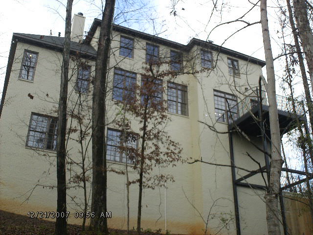

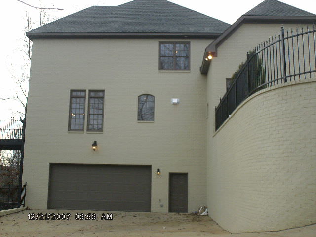

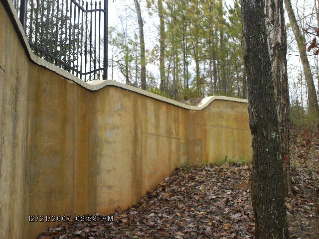

Phillip Posted December 23, 2007 Report Share Posted December 23, 2007 I think the fence should be run to the end of the wall. What do you say? Image Insert: 149.36 KB Image Insert: 120.26 KB Quote Link to comment Share on other sites More sharing options...

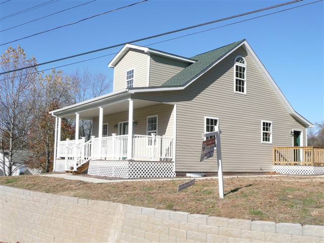

Mark P Posted December 24, 2007 Report Share Posted December 24, 2007 This was a house I did last month. A father was buying the house for his daughter who is a single mom w/ 2 kids. Very nice family. I could just see an excited kid running out the front door, down the steps, and off the wall. Really pretty scary. I started the conversation with " To point out the obvious..." I was amazed that it had not been obvious to them and they had not recognized the potential of an excited kid or unfamiliar visitor leaving at night falling. If I see a potential safety concern, regardless of where it is, I point it out. Image Insert: 70.4 KB Image Insert: 66.33 KB Quote Link to comment Share on other sites More sharing options...
Phillip Posted December 24, 2007 Author Report Share Posted December 24, 2007 This is the back of the house. Image Insert: 139.66 KB This is the retain wall where it is connected to the house and used for the lower driveway. Image Insert: 136.46 KB This is the lower driveway. The retaining wall is to the left. Image Insert: 84.33 KB Quote Link to comment Share on other sites More sharing options...
