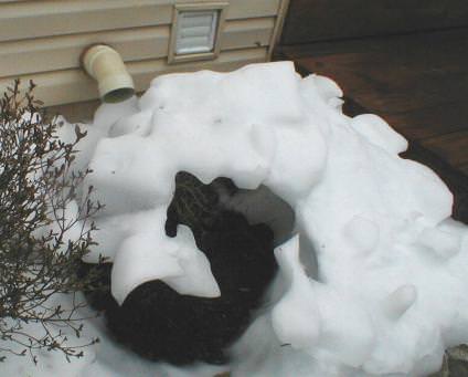

elgato Posted January 8, 2008 Report Share Posted January 8, 2008 I have a client who is concerned about heavy snow restricting air flow and shutting down his furnace. This is a propane high efficiency hot air furnace with PVC ducts to the exterior for combustion air and exhaust. The ducts exit the foundation about 16" above grade on the west side of the home. Drifting snow could easily build up. Any solutions? Can extensions be placed on the PVC piping? Quote Link to comment Share on other sites More sharing options...
Les Posted January 8, 2008 Report Share Posted January 8, 2008 Gregg, Could you post that photo? It would help illustrate conditions. Quote Link to comment Share on other sites More sharing options...
Scottpat Posted January 8, 2008 Report Share Posted January 8, 2008 Also the manufacturer of the system will have specific vent requirements. This is a link to Trane and their install guidelines for a CAT IV system. http://www.trane.com/CPS/uploads/userfi ... 0_0407.pdf Quote Link to comment Share on other sites More sharing options...
elgato Posted January 8, 2008 Author Report Share Posted January 8, 2008 Here's the pic Image Insert: 947.51 KB Quote Link to comment Share on other sites More sharing options...
hausdok Posted January 8, 2008 Report Share Posted January 8, 2008 Hi, Seems to me, it would be a simple thing to put a couple of elbows and extensions on those guys to extend them above the anticipated drift height. I'm not so sure about the exhaust melting the snow. Didn't someone post a photo here last year of a huge icicle that had frozen over the end of one of these things? OT - OF!!! M. Quote Link to comment Share on other sites More sharing options...
Les Posted January 8, 2008 Report Share Posted January 8, 2008 Doesn't it look like someone peed on the foundation just below the left pipe? Quote Link to comment Share on other sites More sharing options...
kurt Posted January 8, 2008 Report Share Posted January 8, 2008 All the spec's I've seen say something like "outlet shall terminate 12" above the highest likely snow level", whatever that means. Either way, it would be easy to fix if it was, in fact, a problem w/snow. Les, do you remember "Who's Next", the seminal Who album from about 1970? Quote Link to comment Share on other sites More sharing options...

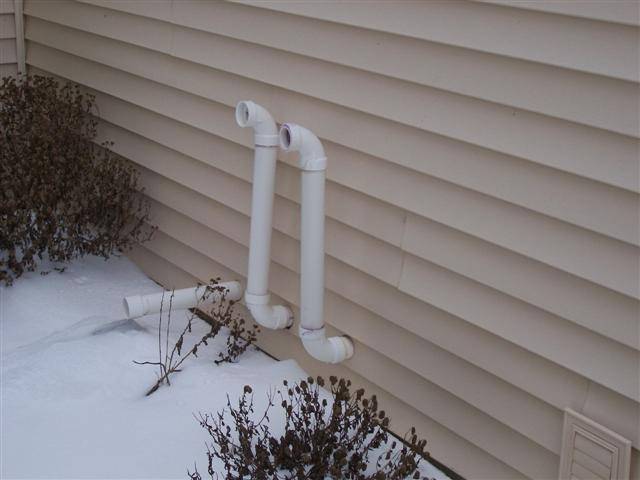

Bill Kibbel Posted January 8, 2008 Report Share Posted January 8, 2008 Quote Link to comment Share on other sites More sharing options...
elgato Posted January 8, 2008 Author Report Share Posted January 8, 2008 I assume that is an exhaust. I guess it makes it's own space. In my photo the left pipe is the exhaust and there is a small amount of condensate dripping from the pipe. Quote Link to comment Share on other sites More sharing options...

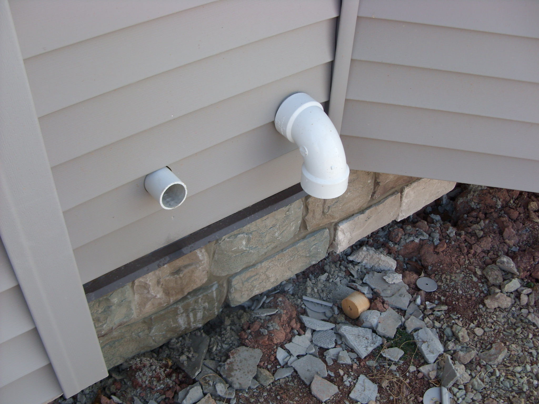

fqp25 Posted January 9, 2008 Report Share Posted January 9, 2008 I see this a lot in my area. Water heater didn't make the rise. (Looks like a set of spy glasses) Image Insert: 109.96 KB[/size= Quote Link to comment Share on other sites More sharing options...

mthomas1 Posted January 9, 2008 Report Share Posted January 9, 2008 Originally posted by kurt All the spec's I've seen say something like "outlet shall terminate 12" above the highest likely snow level", whatever that means. Kurt, I actually ended up researching this a while back, Chicago's greatest recorded snow depth was 29 inches of snow on Jan. 14, 1979, so to meet the 12" rule in Chicago the vent terminal should be at least 41 inches above horizontal external surfaces. IMO, the problem is not so much "snow" as the accumulation of frozen condensation in wet snow, I've seen this happen when the furnace has been off for a few hours in a "setback" period and exhaust passed through a down-turned elbow above a roof - the blockage was not total, but it was enough to trip the back-pressure safety switch. Quote Link to comment Share on other sites More sharing options...

Jerry Simon Posted January 9, 2008 Report Share Posted January 9, 2008 Originally posted by mthomas1 Originally posted by kurt All the spec's I've seen say something like "outlet shall terminate 12" above the highest likely snow level", whatever that means. Kurt, I actually ended up researching this a while back, Chicago's greatest recorded snow depth was 29 inches of snow on Jan. 14, 1979, so to meet the 12" rule in Chicago the vent terminal should be at least 41 inches above horizontal external surfaces. That assumes a lack of snow drifts. You know we get 'em 3'-4' high, if not more, easy. Back as a service manager for a builder, time when the first generation high-efficiency furnaces were installed, I got a call from a neighbor to a house we built that water was coming out of the front door. Turns out the homeowner was in Florida, and didn't know the *low* exterior flue our heating "expert" installed was covered with a snow drift and the furnace couldn't start. That, and the below-zero temps told the story; frozen and burst pipes throughout. As I recall, the house was a week out of warranty. Quote Link to comment Share on other sites More sharing options...

Hearthman Posted January 11, 2008 Report Share Posted January 11, 2008 The 50 cubic feet per 1K BTU formula is to determine if it is a confined space or not if you have less than this much volume supplying MUA to the appliance(s) you must provide MUA per the code. Regarding extending the Cat. IV vent terminations: you must check the mfrs. listed instructions. Since elbows cause pressure drop, many mfrs. limit the pvc runs to three 90degree ells along with X number of lineal feet. Yes, you must allow for snow drifts. If you know one side of the house gets drifts really bad, you may have to terminate on another side of the house. The state of Taxachoosetts now requires a min. 4ft above grade in the wake of a 7 y/o girl's death from snow blockage. Normally, the vacuum switch and hi limit switches would have tripped but the vent within the wall was disconnected so it vented into the wall cavity without tripping the safeties. Same thing can happen with a draft hood equipped water heater sharing the vent with a furnace. The WH can become the vent relief for the furance and it will be perfectly happy venting out the WH draft hood in the event of a blockage. No safeties on most WH draft hoods.... Another problem with making PVC periscopes is freeze-ups. The condensation can totally block the vent termination. Again, check with the mfr. and check your clearances to intakes and windows. HTH, Hearthman Quote Link to comment Share on other sites More sharing options...
Hearthman Posted January 11, 2008 Report Share Posted January 11, 2008 The 50 cubic feet per 1K BTU formula is to determine if it is a confined space or not if you have less than this much volume supplying MUA to the appliance(s) you must provide MUA per the code. Cat. IV furnaces provide their own MUA so this formula does not apply. The sizing of the pvc vent intake is part of the listing by the mfr. Regarding extending the Cat. IV vent terminations: you must check the mfrs. listed instructions. Since elbows cause pressure drop, many mfrs. limit the pvc runs to three 90degree ells along with X number of lineal feet. Yes, you must allow for snow drifts. If you know one side of the house gets drifts really bad, you may have to terminate on another side of the house. The state of Taxachoosetts now requires a min. 4ft above grade in the wake of a 7 y/o girl's death from snow blockage. Normally, the vacuum switch and hi limit switches would have tripped but the vent within the wall was disconnected so it vented into the wall cavity without tripping the safeties. Same thing can happen with a draft hood equipped water heater sharing the vent with a furnace. The WH can become the vent relief for the furance and it will be perfectly happy venting out the WH draft hood in the event of a blockage. No safeties on most WH draft hoods.... Another problem with making PVC periscopes is freeze-ups. The condensation can totally block the vent termination. Again, check with the mfr. and check your clearances to intakes and windows. HTH, Hearthman Quote Link to comment Share on other sites More sharing options...
