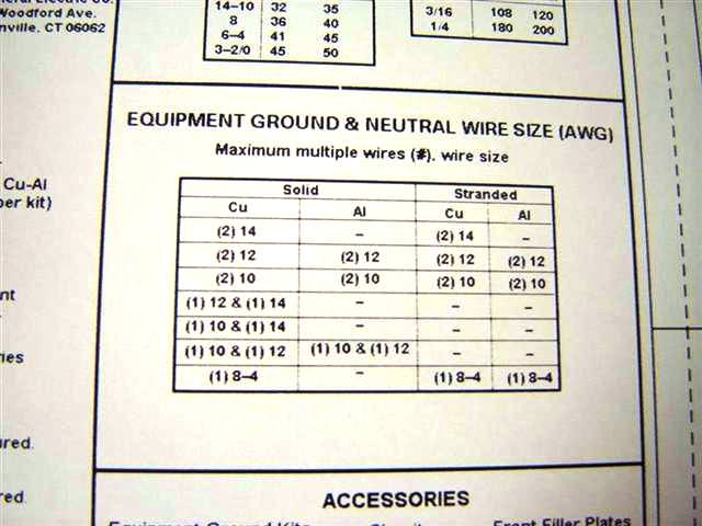

Jim Katen Posted January 17, 2008 Report Share Posted January 17, 2008 Originally posted by Joe Tedesco . . . Look at this now and tell me what is going on? http://www.nachi.org/forum/showpost.php ... stcount=18 The label is attached here too. Image Insert: 47.44 KB I've got a call in to GE to find out whether or not this load center really is listed to accept more than one neutral. I'll let you know what I learn. - Jim Katen, Oregon Quote Link to comment Share on other sites More sharing options...
Bob White Posted January 17, 2008 Report Share Posted January 17, 2008 Seems simple to me when I consider the labelling on the panel plus code.... It's OK to double up grounding conductors in that panel if the conductors meet the size parameters.... It's not OK to do likewise with grounded conductors, 'cause NEC prohibits doing so..... Unless I'm just dense today. What's the argument for multiple neutrals? Quote Link to comment Share on other sites More sharing options...
Joe Tedesco Posted January 17, 2008 Author Report Share Posted January 17, 2008 Thanks Jim, I will wait for the reply from GE, in the meantime I would hang my hat on the 1947 rule through all of the changes, and call it as a defect and if some electrician says otherwise have them put it in writing on their letterhead. Quote Link to comment Share on other sites More sharing options...
Joe Tedesco Posted January 17, 2008 Author Report Share Posted January 17, 2008 Originally posted by Joe Tedesco Thanks Jim, I will wait for the reply from GE, in the meantime I would hang my hat on the 1947 rule through all of the changes, and call it as a defect and if some electrician says otherwise have them put it in writing on their letterhead. Check this out: http://www.lanl.gov/safety/electrical/d ... azards.ppt Quote Link to comment Share on other sites More sharing options...
