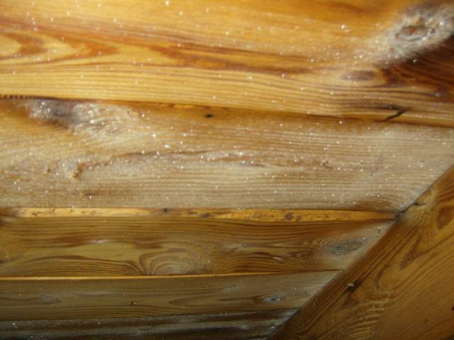

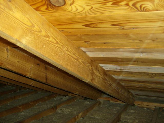

Scott Bachman Posted January 27, 2008 Report Share Posted January 27, 2008 New contributor. Hello to all. I did a roof inspection on Friday for a lender. 1958 house, tongue and groove deckboard, with soffit, gable and ridge vents. There were two isolated areas of frost on deckboard in attic. One area of frost covered deckboard (3'x3') shows obvious leak stains (see photo). The area I am unsure is the other photo. This is a different location in attic, near the eave, above bedrooms. As the photo shows, the frost is on every other T/G deckboard. No signs of leakage/stains. The pattern is what throws me. This is my 1st frost in attic (moved from central Florida last summer). The shingle covering is poor quality, homeowner installed, several years ago. Any info what be helpful. Image Insert: 114.64 KB Image Insert: 119.2 KB Quote Link to comment Share on other sites More sharing options...

Scott Bachman Posted January 27, 2008 Author Report Share Posted January 27, 2008 Yes, southern yellow pine. The shingles were adhered well enough. A local contractor suggested missing tar paper at this location, although that doesn't explain the unusual pattern. Both locations are basically isolated to what is visible in photos. Scott Quote Link to comment Share on other sites More sharing options...
Scott Bachman Posted January 27, 2008 Author Report Share Posted January 27, 2008 Mike, Answer to you other question. Both locations on north facing slope. Scott Quote Link to comment Share on other sites More sharing options...
hausdok Posted January 27, 2008 Report Share Posted January 27, 2008 Hi, So, that's the weather side for NC, right? Seems like it might be a situation where some wind is moving through the roof somehow. Chad might be onto something - were these located on the cold north slope just about in the middle of the attic, so that ventilation at the bottom of the roof plane is almost nil near the eaves because the gable end vents have short-circuited proper eave-to-ridge ventilation. Still, if that's all that's developed on the underside of that roof after half a century with the existing ventilation, I don't think it's going to be a ventilation issue, unless they've made changes to the ventilation configuration. If not, I think you have to figure out whether it's a long-standing non-issue or a recent development caused by something external that is going to become more serious as time goes on. Now, unless the lender hired you as a ventilation specialist, or unless you've got a lot of confidence in your own ability, based on plenty of experience, and are ready and willing to stand behind any correction that you recommend, I hope that you are doing this as a mental exercise only and aren't trying to diagnose this for the lender, because you've done what a home inspector is supposed to, spotted an anomaly and have reported it. Now, recommend they get it checked out and repaired as necessary by a competent roofer - then follow up to see what the roofer found and had to do to repair it - otherwise, you're liable to find someone pointing to you later and saying, "Hey, don't blame me, I didn't diagnose what was causing it, I only did the repairs based on Scott's diagnosis and recommendations for how to repair it." ONE TEAM - ONE FIGHT!!! Mike Quote Link to comment Share on other sites More sharing options...
Scott Bachman Posted January 27, 2008 Author Report Share Posted January 27, 2008 The first photo is near the ridge and near the east gable vent. That one I can attribute to moisture leak. The second photo is at the eave near center of attic. It is the cold north slope. Have seen mostly NW winter winds prevailing. The ridge almost certainly was opened up at the last shingle replacement (approx. 5 years) or the one prior. This is for my information only. Other issues with the roof warrant roof repair/replacement. Last install was a poor attempt by homeowner. My curiosity keeps going back to the pattern on the eave photo. It was very defined, every other T&G deckboard. Thanks for all replies, Scott Quote Link to comment Share on other sites More sharing options...

Les Posted January 27, 2008 Report Share Posted January 27, 2008 Scott, This should be considered strictly anecedotal information. I saw a similiar situation several years ago and asked my Father if he had any ideas why it would happed, Realize my Father was a very fussy carpenter and built many houses. His thought was that southern yellow pine often is booked after sawing and was often shipped with thin stickers in the bunk. As heat drove the sap to the interior of the board, the reversed board would have the sun side toward the attic space and would have more sap and consequently would be less prone to acumulation of moisture (frost). Even if the explaination is wrong, at least it is a talking point and gets the client thinking about ventilation. Quote Link to comment Share on other sites More sharing options...
kurt Posted January 28, 2008 Report Share Posted January 28, 2008 That's interesting. I've been looking @ the photos thinking "what would make alternating boards retain more sap, or be more moisture resistant?" I couldn't think of anything. That explanation makes good sense. Maybe it's wrong, but it makes good logical sense. Quote Link to comment Share on other sites More sharing options...
Scott Bachman Posted January 29, 2008 Author Report Share Posted January 29, 2008 Les, That's the type of explanation I was looking for. Nothing else seems to fit. Scott Quote Link to comment Share on other sites More sharing options...
