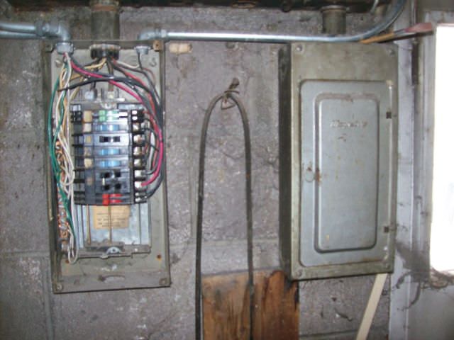

mridgeelk Posted February 6, 2008 Report Share Posted February 6, 2008 I found these Zinsco panels in a commercial setting today. They are 60+/- years. Are Zinsco panels of this vintage problematic/unsafe as the more recent versions? Image Insert: 294.03 KB Quote Link to comment Share on other sites More sharing options...
randynavarro Posted February 6, 2008 Report Share Posted February 6, 2008 Yes. Quote Link to comment Share on other sites More sharing options...
Les Posted February 6, 2008 Report Share Posted February 6, 2008 Yes, but they don't look 60yrs old. Quote Link to comment Share on other sites More sharing options...

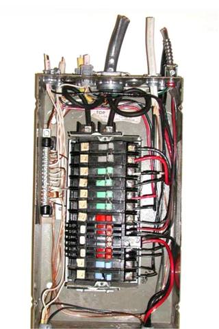

hausdok Posted February 6, 2008 Report Share Posted February 6, 2008 Hi, I agree with Les, those are Magnatrip panels. I'd bet a Domino's pizza that they're mid-1950's to 1960. Here's a 1958 Magnatrip that a customer gave me after it has been removed. I stripped it out, sent it to Douglas Hansen to use as a training aid, and he re-wired it and shot me this photo. Image Insert: 30.96 KB OT - OF!!! M. Quote Link to comment Share on other sites More sharing options...
mridgeelk Posted February 6, 2008 Author Report Share Posted February 6, 2008 THEY MAY BE AS NEW AS 1960 +/- Quote Link to comment Share on other sites More sharing options...
hausdok Posted February 6, 2008 Report Share Posted February 6, 2008 Yep OT - OF!!! M. Quote Link to comment Share on other sites More sharing options...
Les Posted February 6, 2008 Report Share Posted February 6, 2008 Sure hope Chad does not see that fan belt from a 1968 Chev hanging between the panels! Quote Link to comment Share on other sites More sharing options...

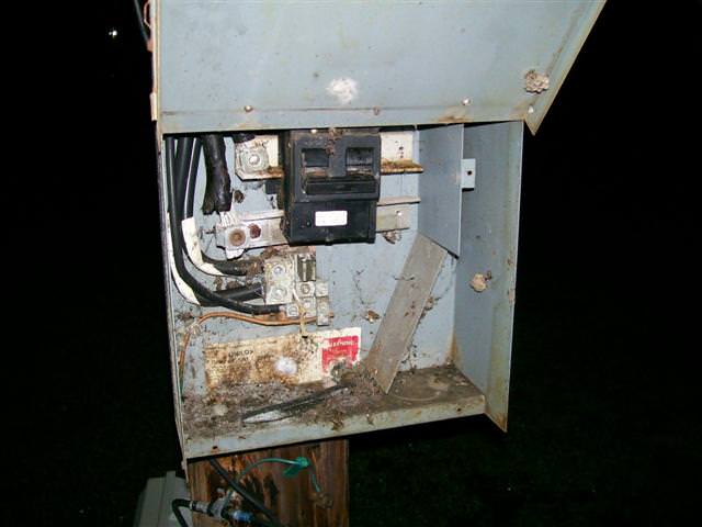

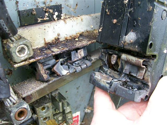

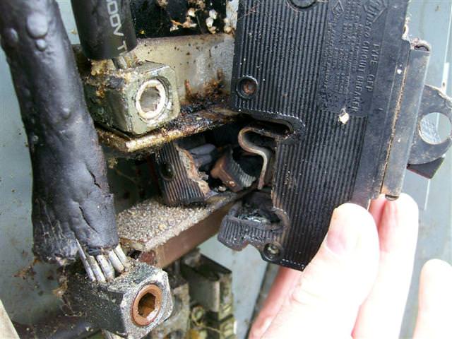

hausdok Posted February 20, 2008 Report Share Posted February 20, 2008 Hi All, Got this email today. After looking at this, I don't think many of you are going to want to say, "Oh well, I don't see anything to be concerned with here," when you run into a Zinsco panel in the future. Enjoy OT - OF!!! M. ---------------------------------- Mike, I just got these pictures of a badly damaged Zinsco main that failed. In this case the failure damaged the main wire to a mobile home also (you can see the melted wire to the left of the main). This is a good example of why I do not like to see anyone remove these breakers. You can not tell how bad they are damaged by looking at them. Please feel free to post them or use them on web sites - Thanks for getting the word out. Jim P. Simmons - Mr. Electric Quote Link to comment Share on other sites More sharing options...
Brian G Posted February 20, 2008 Report Share Posted February 20, 2008 But it's been working for years with no problems..... [:-mischie Brian G. Crispy Critter [:-bigeyes Quote Link to comment Share on other sites More sharing options...
