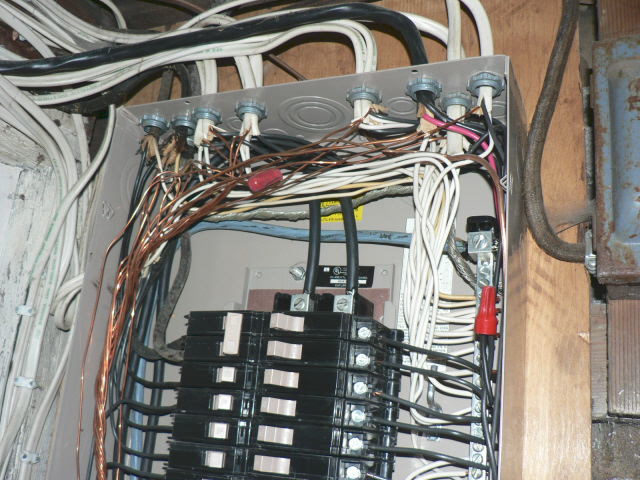

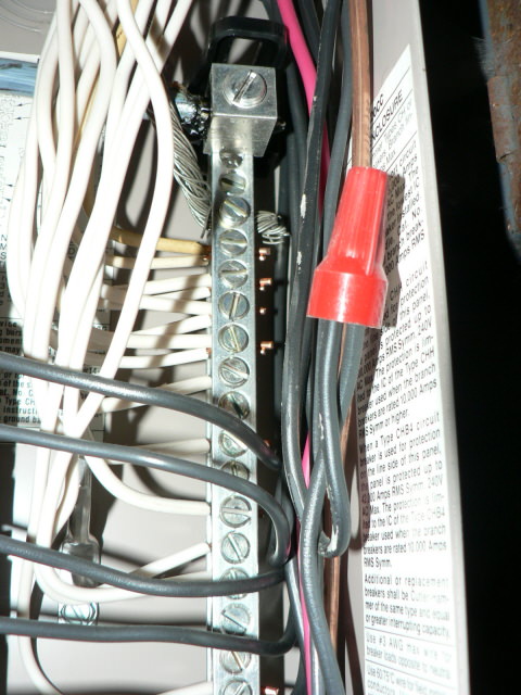

jodil Posted February 11, 2008 Author Report Share Posted February 11, 2008 Image Insert: 206.12 KB Image Insert: 186.05 KBI dont have a picture of the main disconnect, but I do have a couple of the panel. There are a couple other issues on this panel since I am posting the pics that you may comment on as well. Notice the neutral wires, most having two neutrals under one terminal screw. I have been going out on jobs with an electrician and he says this is a no no. However, I have heard other wise. Your thoughts? Also notice the double tapped breaker. I have read the other posts on this site about your opinions about double taps, but in 62 inspections, I have had 3 main panels that DID NOT have at least one double tapped breaker... So, the double tap in ths pic is on a Cutler Hammer breaker. How do I know if that is the type Cutler makes that allows for two wires? thank you for helping me you're wonderful! Image Insert: 240.58 KB Quote Link to comment Share on other sites More sharing options...
Jim Baird Posted February 11, 2008 Report Share Posted February 11, 2008 Jodi, I can't quote you the section, but since the '02 NEC the dbl tap neutrals are not to code. These might be from b4 '02? Dbl tap ungroundeds are generally not kosher. Quote Link to comment Share on other sites More sharing options...
Jim Katen Posted February 11, 2008 Report Share Posted February 11, 2008 Originally posted by jodil . . . I dont have a picture of the main disconnect, but I do have a couple of the panel. You'll find that it's a good habit to take establishing shots of things, then take shots that are progressively closer. It makes it easier to show people what you saw when you have questions. Also, years later, it will help you to define what was present at the time of the inspection. There are a couple other issues on this panel since I am posting the pics that you may comment on as well. Notice the neutral wires, most having two neutrals under one terminal screw. I have been going out on jobs with an electrician and he says this is a no no. However, I have heard other wise. Your thoughts? Your electrician friend is correct. It is now and it has always been improper to place two neutral wires under a single lug. However, it's a minor error; lots of electricians wired lots of houses this way and it hardly ever causes trouble. I recommend that folks have this fixed the next time an electrician is present for other repairs. While he's there, he can also secure those cables within 12" of the enclosure. Also notice the double tapped breaker. I have read the other posts on this site about your opinions about double taps, but in 62 inspections, I have had 3 main panels that DID NOT have at least one double tapped breaker... So, the double tap in ths pic is on a Cutler Hammer breaker. How do I know if that is the type Cutler makes that allows for two wires? That's a type CH breaker. It's designed to hold two wires. If you were to look at the side of the breaker that's facing down, you'd see, embossed in the plastic, a chart that shows how many of what size wires can be inserted in the lug. Next time you're at Home Depot, look at some of the breakers. Once you've seen the style of lug, you'll remember it. Also, note that, when you put two wires under a CH breaker, you're supposed to tighten the lug to 30 lb/in. That's pretty snug. The single biggest problem that I see in the pictures is that all of the equipment grounding conductors are bunched together under a single lug. That lug isn't listed to hold all of those itty-bitty wires. Some of them are, undoubtedly, loose. The installer should have installed an accessory grounding bar. The good news is that I see that the installer used a 4-wire feeder and he separated the grounds and the neutrals. - Jim Katen, Oregon Quote Link to comment Share on other sites More sharing options...

Jim Katen Posted February 11, 2008 Report Share Posted February 11, 2008 Originally posted by Jim Baird Jodi, I can't quote you the section, but since the '02 NEC the dbl tap neutrals are not to code. These might be from b4 '02? Jim B is correct in that the specific prohibition came into the NEC in the '02 edition. It first appeared in 384, and was then moved to 408. However, lest anyone come away from this thinking that double-tapped neutrals were allowed before '02, let me add that there's another, much older, prohibition at 110.14(A). It says, " . . . Terminals for more than one conductor . . . shall be so identified. " 110.14(A) is a much older reference than 408.41. It goes back to the early part of the 1900s. For all practical purposes, it has never been ok to place two neutral wires under a single terminal. -Jim Katen, Oregon Quote Link to comment Share on other sites More sharing options...

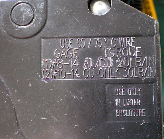

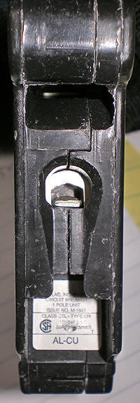

Ken Meyer Posted February 11, 2008 Report Share Posted February 11, 2008 Also notice the double tapped breaker. I have read the other posts on this site about your opinions about double taps, but in 62 inspections, I have had 3 main panels that DID NOT have at least one double tapped breaker... So, the double tap in ths pic is on a Cutler Hammer breaker. How do I know if that is the type Cutler makes that allows for two wires? That's a type CH breaker. It's designed to hold two wires. If you were to look at the side of the breaker that's facing down, you'd see, embossed in the plastic, a chart that shows how many of what size wires can be inserted in the lug. Next time you're at Home Depot, look at some of the breakers. Once you've seen the style of lug, you'll remember it. Also, note that, when you put two wires under a CH breaker, you're supposed to tighten the lug to 30 lb/in. That's pretty snug. Here are some pix of what Jim is talking about. Image Insert: 441.68 KB Image Insert: 171.46 KB Image Insert: 180.61 KB Quote Link to comment Share on other sites More sharing options...
msteger Posted February 11, 2008 Report Share Posted February 11, 2008 Is that a copper service grounding wire at the top of the neutral bar on the right side of the 1st photo? Maybe what I thought I saw isn't a grounding wire. Does anyone else see what I thought I saw? Quote Link to comment Share on other sites More sharing options...
Jim Katen Posted February 12, 2008 Report Share Posted February 12, 2008 Originally posted by msteger Is that a copper service grounding wire at the top of the neutral bar on the right side of the 1st photo? Maybe what I thought I saw isn't a grounding wire. Does anyone else see what I thought I saw? I suspect that it's a bonding wire, it probably goes to a water pipe. - Jim in Oregon Quote Link to comment Share on other sites More sharing options...
