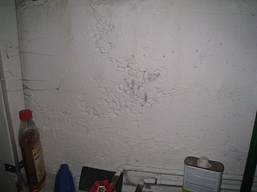

Chris Bernhardt Posted February 14, 2008 Report Share Posted February 14, 2008 Would you comment on honey combs in concrete basement foundations even when there has been no history of moisture intrusion thru them? Or so they say. Image Insert: 82.43 KB Chris, Oregon Quote Link to comment Share on other sites More sharing options...
chrisprickett Posted February 14, 2008 Report Share Posted February 14, 2008 Looks to me like air pockets in the form when the wall was poured. Its hard to tell from that picture, combined with the paint. Quote Link to comment Share on other sites More sharing options...
kurt Posted February 14, 2008 Report Share Posted February 14, 2008 In my market (old inner city houses), something like that wouldn't get a mention. If it was a brand new house, it would. In the broad picture, it doesn't look all that serious either way; I could argue it both ways, but it would mildly pedantic. After that, if there was water coming through, you'd see the paint blistering & peeling. Quote Link to comment Share on other sites More sharing options...
Les Posted February 15, 2008 Report Share Posted February 15, 2008 it is not honeycomb. It was a dry pour or a "lunch-line". Does not mean squat if it does not leak. Quote Link to comment Share on other sites More sharing options...
hausdok Posted February 15, 2008 Report Share Posted February 15, 2008 Originally posted by Les it is not honeycomb. It was a dry pour or a "lunch-line". Does not mean squat if it does not leak. Or, instead of dumping that last trough load of washed out tailings on the ground they dumped them into the fresh mud. OT - OF!!! M. Quote Link to comment Share on other sites More sharing options...
kurt Posted February 15, 2008 Report Share Posted February 15, 2008 Have you ever seen how, if the mud isn't shot down clean into the form, i.e., it bounces and ricochets back & forth off the opposite walls of the forms, it separates? This wouldn't be that, would it? It's sort of a similar look, though, isn't it? Quote Link to comment Share on other sites More sharing options...
Les Posted February 15, 2008 Report Share Posted February 15, 2008 Naw, likely just a little too much holy water added by truck driver and the worker folded it on top of concrete of the correct slump. Or there was a delay between two loads or it was a cold weather pour. Regardless it really does not mean much. Quote Link to comment Share on other sites More sharing options...
Jim Katen Posted February 15, 2008 Report Share Posted February 15, 2008 Originally posted by Chris Bernhardt Would you comment on honey combs in concrete basement foundations even when there has been no history of moisture intrusion thru them? Or so they say. Chris, Oregon Completely unimportant. - Jim Katen, Oregon Quote Link to comment Share on other sites More sharing options...
