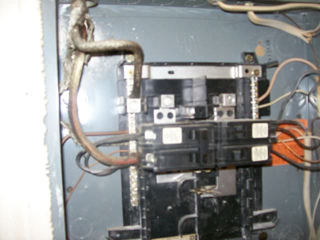

mridgeelk Posted February 27, 2008 Author Report Share Posted February 27, 2008 In the first picture you can see at the eaves where one leg of the service is not in use, this is case on all four services as each unit has its own service. See additional picture of a different service. The picture of a panel shows numerous problems, note the jumpers used to supply power A to B Image Insert: 308.75 KB Image Insert: 390.62 KB Originally posted by jon_ran I think that he means that instead of having 120/240 capability, the SEC is split to go to 2 separate services, supplying each with 120. The concept can be confusing if you don't understand it. We call a service with a single SEC as 120, 2 SEC's is 120/240, but 3 SEC's is 3 phase. Quote Link to comment Share on other sites More sharing options...
