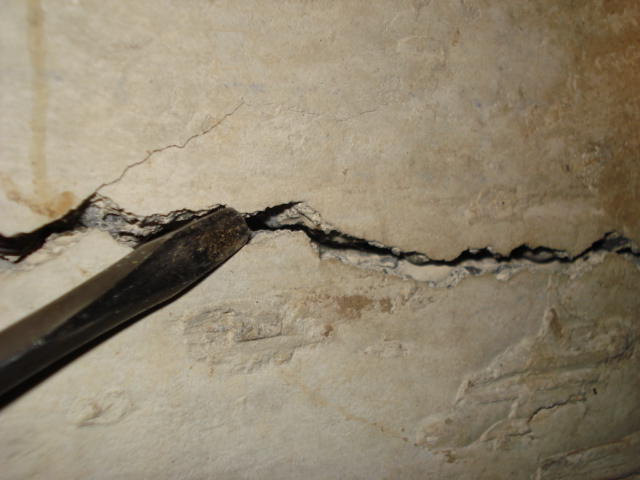

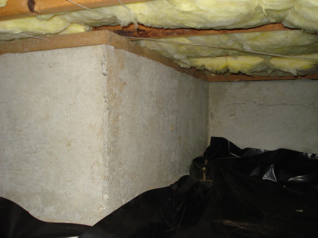

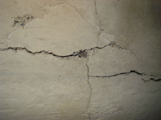

randynavarro Posted February 27, 2008 Report Share Posted February 27, 2008 First time I've seen something like this. Home is single story. 1981. Standard poured footing and 20" or so stem wall. Image Insert: 153.42 KB The cracks runs horizontally across most of the front section of the home. Image Insert: 141.66 KB This is the biggest the crack gets. Image Insert: 152.84 KB Every so often, there's this cross-cracking phenomenon. There were three of them. Image Insert: 160.96 KB The cracking continues and ends. Crazy I say!! Any thoughts? Quote Link to comment Share on other sites More sharing options...
AHI in AR Posted February 27, 2008 Report Share Posted February 27, 2008 Poured concrete foundations are extremely rare in my neck of the woods so I don't have much experience with them, but without any other info, my first inclination is to guess that it's due to lateral soil pressure. Where was the soil level outside this wall? Quote Link to comment Share on other sites More sharing options...
Darren Posted February 27, 2008 Report Share Posted February 27, 2008 Kevin, Looking at the pictures, the exterior grade can't be much higher than the location of the crack. I noticed there's little to no cracking at the inside corner (which is acting as a shear wall). I'm wondering if there put something in the pour to act like rebar that's has a different expansion rate. Whatever it is, call for a structural review (hopefully they tell you what they find so you can tell us). Darren www.aboutthehouseinspection.com Quote Link to comment Share on other sites More sharing options...
AHI in AR Posted February 28, 2008 Report Share Posted February 28, 2008 Originally posted by Darren Kevin, Looking at the pictures, the exterior grade can't be much higher than the location of the crack. Whatever it is, call for a structural review (hopefully they tell you what they find so you can tell us). Darren www.aboutthehouseinspection.com That's why I asked about the soil line. I can only speculate that there was soil placed against the concrete prior to a full enough cure. That might set up tiny stress cracks that could later grow, right? Especially if heavy equipment got too close to the wall. If the soil line is essentially at the same level as the crack that would be my guess as to the cause. However, there are too many unknowns to say for sure. Do let us know what the cause is. Quote Link to comment Share on other sites More sharing options...
Chad Fabry Posted February 28, 2008 Report Share Posted February 28, 2008 It looks like the concrete was placed too wet and the aggregate is all #1 and smaller. Hardly an ideal mix for a foundation. I'd bet it's easily crumbled with little resistance to impact. It has the distinctive look of a cement starved mix. Quote Link to comment Share on other sites More sharing options...
hausdok Posted February 28, 2008 Report Share Posted February 28, 2008 Hi Randy, Call for a structural and insist it be a guy who's intimately familiar with residential foundations 'cuz they're a different animal than commercial jobs. You could call Dave Pioli at Criterium in Bothell, or, I've heard that Bodine has an engineer on staff. Either way, hHorizontal cracking should always be called, and, in this case, I bet you've got a stemwall that's fractured because of liquifaction movement - probably during the 1996 or 2001 quakes. ONE TEAM - ONE FIGHT!!! Mike Quote Link to comment Share on other sites More sharing options...
randynavarro Posted February 28, 2008 Author Report Share Posted February 28, 2008 ...my first inclination is to guess that it's due to lateral soil pressure There's not a lot of soil outside, maybe 18" or so. I'm hard pressed to think it's soil pressure. I'm wondering if there put something in the pour to act like rebar that's has a different expansion rate. I like that idea. It looks like the concrete was placed too wet and the aggregate is all #1 and smaller. Hardly an ideal mix for a foundation. I'd bet it's easily crumbled with little resistance to impact. It has the distinctive look of a cement starved mix. Well, being totally blindsided with this one and not really having many other theories, I might buy into that for a buck. Call for a structural and insist it be a guy who's intimately familiar with residential foundations 'cuz they're a different animal than commercial jobs Done I probably won't hear a thing about any engineer or additional evaluations. The client is a single lady with some kids; the house has a Stab-Lok panel and mold / mildew in the attic. She didn't look so well when we were done, unfortunately. Quote Link to comment Share on other sites More sharing options...

Brandon Chew Posted February 28, 2008 Report Share Posted February 28, 2008 Dang! I wrote a nice long reply. After I previewed it and proofed it, I hit the wrong button and lost it all. I'm too bummed to write it again. The gist of what I wrote: Any thoughts? The concrete looks funky. Mix looks wet to me. If so, concrete is weak. (Agree with Chad) Was the wall still in the same plane above and below the horizontal cracks, or was it bowed and hinging along the cracks? If it was due to hydrostatic pressure, expansive soils, or frost heave, I'd expect the cracking to be further below grade than you are showing in the pics, and I'd expect to also see bowing. It looks to me like someone grabbed the house by the footings, shook it, and the foundation tried to shear off where it came out of the ground. (Agree with Mike) If this is seismic damage and the concrete is weak (Chad and Mike are both right), the fix could be as extensive as having to jack the house up and replace the foundation. So on that note, and based on your description of the buyer, it might be fortunate that she's nervous (Agree with Eric). The house could still be a good deal for a buyer with deep pockets if the price is right. By the way, I don't try to sway my client either way regarding the purchase. I try to give my client good, clear information so they can make a decision about what is right for them. I'd call for evaluation by a PE that has experience with residential foundations. (Agree with Mike and You) If an evaluation is done I'd be interested in hearing about the findings and the recommended fix. Quote Link to comment Share on other sites More sharing options...
Jim Katen Posted February 28, 2008 Report Share Posted February 28, 2008 Wet mix. Bad juju. -Jim Katen, Oregon Quote Link to comment Share on other sites More sharing options...
