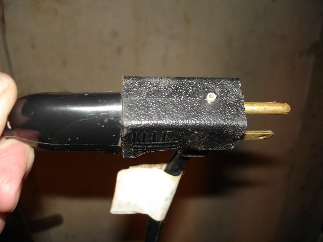

Eric B Posted February 29, 2008 Report Share Posted February 29, 2008 The ones that can catch me are the Hyro-Matic pumps with vent tubes. I've had a couple of occasions where I sucked water back up through the vent. I think this is where the term "every action causes a reaction" came from. Quote Link to comment Share on other sites More sharing options...
mthomas1 Posted February 29, 2008 Report Share Posted February 29, 2008 Eric, As I'm not familiar with these I looked up the site: http://www.hydromatic.com/ But I'm still missing something, what's the issue with testing these? - Thanks Quote Link to comment Share on other sites More sharing options...

Eric B Posted March 1, 2008 Report Share Posted March 1, 2008 Michael, Go here: http://www.hydromatic.com/effluent/spd50.html Instead of a float, you will see a black chamber next to the pump. On the bottom of this chamber is a rubber diaphragm. As the water in the sump rises it creates pressure on the diaphragm and activates the pump. From the chamber is a tube that runs up the power cord to the plug. In the attached picture is a hydro-matic plug with the white vent tube. If you suck on the tube you will cause the diaphragm to pull up much as it would from water pressure. This will close the switch and activate the pump. Now, when you suck on the tube you must then place a finger over the tube to prevent air from re-entering and filling the partial chamber vacuum that you created by sucking air out. Plug the plug into the outlet with finger on vent tube and pump will run until you remove the finger, then pump shuts off. By plugging in the secondary plug you bypass the pump switch and only confirm that the pump runs - this will not confirm the switch's function which sometimes has failed. Image Insert: 134.1 KB Quote Link to comment Share on other sites More sharing options...
