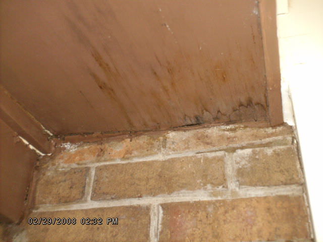

Phillip Posted March 3, 2008 Report Share Posted March 3, 2008 Did the flashing look like this? Image Insert: 169.15 KB Image Insert: 70.26 KB Roof is two years old. Quote Link to comment Share on other sites More sharing options...
John Dirks Jr Posted March 3, 2008 Author Report Share Posted March 3, 2008 Wow! A valley directing water right to the chimney. Now that's friggin brilliant! I wonder who gets the credit for that trouble free design? Was there some kind of an addition that led to that or was that the original design? Quote Link to comment Share on other sites More sharing options...

hausdok Posted March 3, 2008 Report Share Posted March 3, 2008 Originally posted by AHI So you see my point. It's easy to see the evidence of water penetration near the chimney. It's not always easy to determine the exact cause. And you're not required to determine the exact cause. It's the job of whichever specialist comes out to look things over to determine what's causing it and to repair it. The job is defect recognition. You see wet sheathing and lousy flashings, you can state that you think the leak is coming from the flashings but you might be wrong - especially if you didn't bother to examine the crown as well. You see a crack in the crown, you can state that the water intrusion might be coming from the crown, but, again, you might be wrong, 'cuz it might have come in through the flashings. If you can tell what caused it at a quick glance, fine, otherwise, identify the issue, explain why it's bad for the home, suggest a course of action, and move on; don't hang around trying to be be a house whisperer. ONE TEAM - ONE FIGHT!!! Mike Quote Link to comment Share on other sites More sharing options...
Phillip Posted March 3, 2008 Report Share Posted March 3, 2008 Originally posted by AHI Wow! A valley directing water right to the chimney. Now that's friggin brilliant! I wonder who gets the credit for that trouble free design? Was there some kind of an addition that led to that or was that the original design? There is a sun room that was added on. The bad thing is I see this 2 to three times a year. Quote Link to comment Share on other sites More sharing options...
