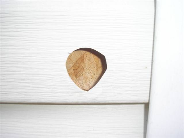

Pete Dolhonde Posted October 11, 2009 Report Share Posted October 11, 2009 I've just received delivery of a new mobile home for my mother.. This home is located in southern Louisiana (i.e. wet and dame). The home is sided with vinyl over OSB but has NO moisture barrier. Quiestion is, does 2006 IRC R703.4 apply to mobile homes also?? Just thought I'd ask the Pros. Thanks..Pete Quote Link to comment Share on other sites More sharing options...
resqman Posted October 12, 2009 Report Share Posted October 12, 2009 No. The IRC does not apply to manufactured or mobile homes. Quote Link to comment Share on other sites More sharing options...
Pete Dolhonde Posted October 13, 2009 Report Share Posted October 13, 2009 Didn't think so..just wanted to make sure..I'd heard conflicting views both ways..but thanks for the get back Mr. Ramsey...Pete Quote Link to comment Share on other sites More sharing options...
