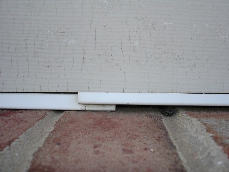

jayreeder Posted March 11, 2008 Report Share Posted March 11, 2008 We're building a house down here in Georgia and the siding installer didn't put flashing between the brick wall (3 ft tall) and hardi siding band above. All the other houses have that flashing but he said they didn't need it because the drip edge on the top of the band will prevent water from getting in the brick wall cavity. Should I be concerned? These are pictures of the home we're building with the drip edge above the trim band but no flashing between the trim band and the brick: These are pictures of a home in our area that did include the drip edge above the trim band and the flashing between the band and the brick wall: I read about IRC 703.8 and UBC 1402.2/1405.3 in other posts here. Would the construction of our brick/siding pass that code? Thanks for any advice... Jay Quote Link to comment Share on other sites More sharing options...
hausdok Posted March 11, 2008 Report Share Posted March 11, 2008 Hi, Well, at least your brick is sloped to drain; the other fellow's isn't. Seriously, there should be a cavity behind the brick to allow drainage anyway. The only reason that you want flashing there is to provide a capillary break between the brickwork and that horizontal wood trim. There should be a little flashed gap of about 1/8-inch to 3/16-inch between the bottom of the trim and the brickwork and the flashing should slope out and down onto the sloped soldier row. So, without the flashing, you've got the possibility of some moisture moving from the brickwork into the woodwork when it rains (if the woodwork wasn't properly primed and painted) and there's a possibility that some wind-driven water will be blown into that little gap under the bottom of the trim at the inner top edge of the bricks. As for the neighbor's house, the guy who installed that horizontal trim on the other guy's house has his head tucked up his bottom. Hi put the horizontal bandboard tight to the flashing and the flashing tight to the brick, and used flashing that has a pre-formed lip, which caused it to bend upward. Now it drains toward the trim instead of away. Gotta wonder what kind of dildo for brains did that work. ONE TEAM - ONE FIGHT!!! Mike Quote Link to comment Share on other sites More sharing options...
jayreeder Posted March 11, 2008 Author Report Share Posted March 11, 2008 Mike, Thanks for the reply. Would I be ok if they caulk the joint between the siding band and the brick? That's the recommendation. Given the water barrier behind the brick wall and the weep holes, everyone is telling me that you can't keep water from getting behind the brick anyway and it would be ok even without the caulk. Thanks, Jay Quote Link to comment Share on other sites More sharing options...
Chad Fabry Posted March 11, 2008 Report Share Posted March 11, 2008 Thanks for the reply. Would I be ok if they caulk the joint between the siding band and the brick? That's the recommendation. No. It needs to be flashed. It's important. In the picture with the brick sample..I think it was the third one; don't you think it'd look better if the vertical trim extended all the way to the brick rather than to the top of the horizontal trim ( water table)? I know you're excited about your new house but that is one funky looking detail. Since they have to peel off the water table, get them to fix that at the same time. Quote Link to comment Share on other sites More sharing options...
jayreeder Posted March 11, 2008 Author Report Share Posted March 11, 2008 Chad, Thanks for the reply. Actually pictures #1 and #2 are my house without the flashing between the brick and the hardi trim band. Pictures #3 and #4 are of another house that has the flashing between the brick and the hardi trim band. Every house I can find that has a 1/2 brick wall with hardi siding above has flashing between the brick and the hardi trim band. Pictures #3 and #4 are examples of that. My builder and his siding sub are telling me that the flashing isn't important between the brick and the hardi siding band because water will get behind the brick wall either way and it's designed to handle it. However, they conceded that if I wanted to, they would caulk that joint. Quote Link to comment Share on other sites More sharing options...

jayreeder Posted March 11, 2008 Author Report Share Posted March 11, 2008 Kurt, So if the drainage is ok in the brick wall with weeps and all, am I ok? I'm being told that you can't keep water from getting behind the brick wall anyway and the drainage will handle it. That and the drip edge on top of the siding band are reasons why we don't need flashing between brick and band. I'm meeting with the siding guy tomorrow and I just need to know if I should insist on the flashing or if the caulk or no action is ok. If I insist then it'll be me against the builder, site super, and siding contractor. I'd like to sound like I know what I'm talking about Thanks again, Jay Quote Link to comment Share on other sites More sharing options...
kurt Posted March 11, 2008 Report Share Posted March 11, 2008 One other observation made by Brandon in another conversation he and I are having........ Is the black material in the photo (left of the door opening) the through wall flashing? If it is, it looks like it is lapped over the housewrap. That means water entering the wall runs down behind the flashing and into the interior. The idea that water runs downhill and that lap details have to be OVER each other as one works up a wall are ideas that escape a surprising number of contractors. Not trying to start an avalanche here, but there's things to consider that the contractor doesn't seem to be cognizant of. To answer your question though..... If the drainage in the wall is OK, yes, you'll also be OK. While many folks refuse to believe this, you can look at this stuff and know if it's OK or not. Just imagine water getting behind the brick, and visualize where it would go. If you're seeing areas it can flow into, then it will. If you're seeing details that direct and divert the water to the exterior in a logical gravitational path, then the water will go to the exterior. It isn't rocket surgery. Water runs downhill in the path of least resistance. Don't get too hung up on code language (it's arcane), silly contractors ideas about flashings (most don't have a clue and will say anything to appear knowledgeable), or anything else. Look for holes and gaps, and figure out what happens when the water gets in them (because it will). Quote Link to comment Share on other sites More sharing options...

Eric B Posted March 11, 2008 Report Share Posted March 11, 2008 I frequently see missing flashing between siding transitions. I also often see flashing caulked up. I report both since it is not best practice and makes no sense to ignore any opportunity to reduce water infiltration and allow water drainage. The contractors are the same here with their brainless reasoning. In the attached from last Friday the flashing had poor overlap and allowed water entry underneath. People seem to forget about what a good wind driven rain can do. Image Insert: 77.89 KB Quote Link to comment Share on other sites More sharing options...
hausdok Posted March 11, 2008 Report Share Posted March 11, 2008 Hi, Jay, you keep referring to that as a Hardi trim band. I couldn't tell from the photo that the piece of trim was fiber-cement. If it is, the answer is simple - there must be flashing because Hardie requires a capillary break between their product and concrete or brickwork. OT - OF!!! M. Quote Link to comment Share on other sites More sharing options...
