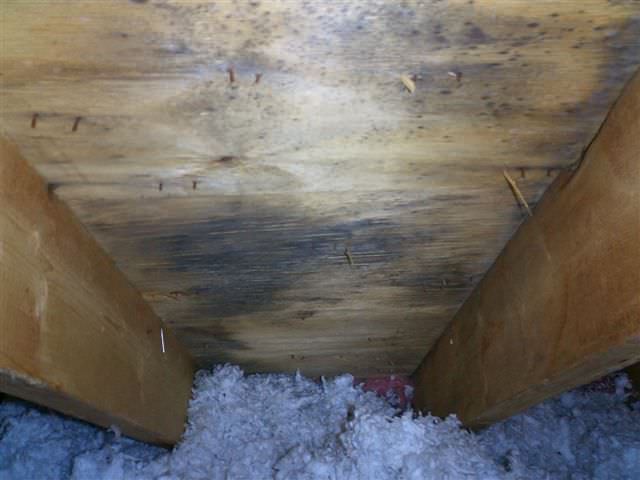

Bradd Judd Posted October 26, 2005 Report Share Posted October 26, 2005 I just had to chime in on this one....... I love going to a particular area in The Northwest Suburbs of Chicago, because it's garenteed for me to find mold on the roof sheathing from the bathroom exhaust fans exiting the air directly onto the interior of the roofing structure. The municipality inspector must have thought this was ok (as well in his own mind) as the attic being "outside" since I find it on every single home in the same devlopment by the same builder of only 10-12 year old homes.....Let me see if I have a picture of this.... This is not the best one I had, but it gets the point across.......... [^] Download Attachment: mold.jpg 54.22 KB Quote Link to comment Share on other sites More sharing options...

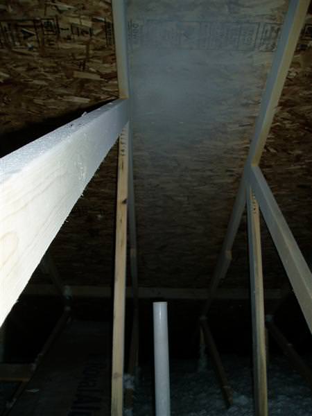

swarga Posted March 27, 2006 Report Share Posted March 27, 2006 Allow me to explain what they are talking about. The plumber installed a metal flex line to the vent fan and ran it up to a hole in the roof sheathing. There is a vent cap installed the issue is the vent is four inches away from the opening. Not 4 feetaway not in the insulation, Not un-vented. We are talking about 4". I see it all of the time here. In My opinion it does not need to be fixed. Now if there was no other vents, I would write it up, if it was 4 feet from the opening I would write it up, but I am not going to pitch a fit over a 4" air gap. Quote Link to comment Share on other sites More sharing options...
Chad Fabry Posted March 27, 2006 Report Share Posted March 27, 2006 In my climate it is almost always a problem and there is almost always moisture damage. I write it as a defect and recommend that it be corrected. Quote Link to comment Share on other sites More sharing options...
hausdok Posted March 27, 2006 Report Share Posted March 27, 2006 Same here. I've had them where they're wired off with the nozzle halfway into the jack opening and found the decking around the opening rotting. I suppose there are climates where one can get away with it but I'd call it nonetheless. There's a reason that there is a male extension on exhaust fan outlets. ONE TEAM - ONE FIGHT!!! Mike Quote Link to comment Share on other sites More sharing options...

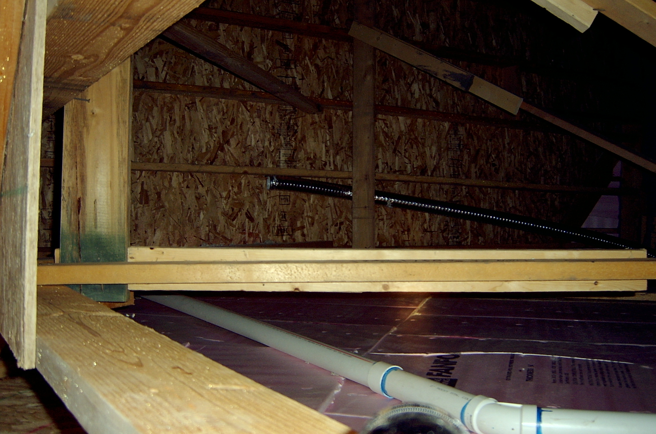

lallij Posted October 24, 2007 Report Share Posted October 24, 2007 [You talk code. Is that new house construction or remodeling? Can remodleing construction really be controlled? Download Attachment: SV400030.JPG 1762.86 KB I found this on an inspection last week. This is a flex hose coming from the master bathroom fart fan. I have tried to find out via the IRC 2003 if this is legal. Can anyone confirm? This is venting directly into the attic over the garage portion of the home. I was taught in inspection training school that nothing should vent into the attic, but I do not know if that is code or just a recommendation. Thanks, Dan Quote Link to comment Share on other sites More sharing options...
hausdok Posted October 24, 2007 Report Share Posted October 24, 2007 Hi, Here're a few quotes I found doing a 5-minute search of the archives. One is clearly from 2000. I don't know when the others are, but I doubt that they've gone backward since then. 2000 Mechanical Code: 501.3 Outdoor discharge. "The air removed by every mechanical exhaust system shall be discharged outdoors at a point where it will not cause a nuisance and from which it cannot again be readily drawn in by a ventilating system. Air shall not be exhausted into an attic or crawl space." SECTION M1502 RANGE HOODS M1502.1 General. Range hoods shall discharge to the outdoors through a singleââ¬âwall duct. The duct serving the hood shall have a smooth interior surface, shall be air tight and shall be equipped with a backdraft damper. Ducts serving range hoods shall not terminate in an attic or crawl space or areas inside the building. IRC M1501.1 Outdoor discharge. the air removed by every mechanical exhaust system shall be discharged to the outdoors. Air shall not be exhausted into an attic, soffit, ridge vent or crawl space. ONE TEAM - ONE FIGHT!!! Mike Quote Link to comment Share on other sites More sharing options...
