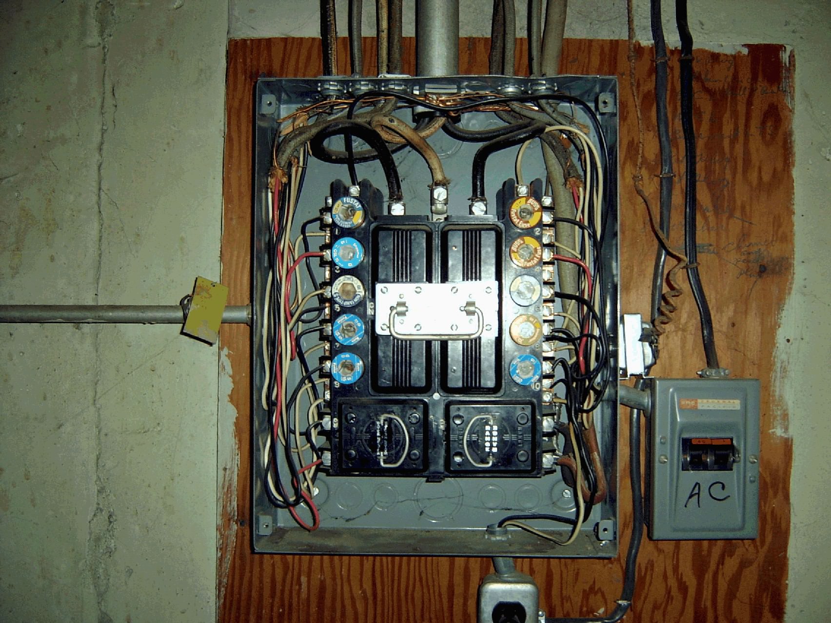

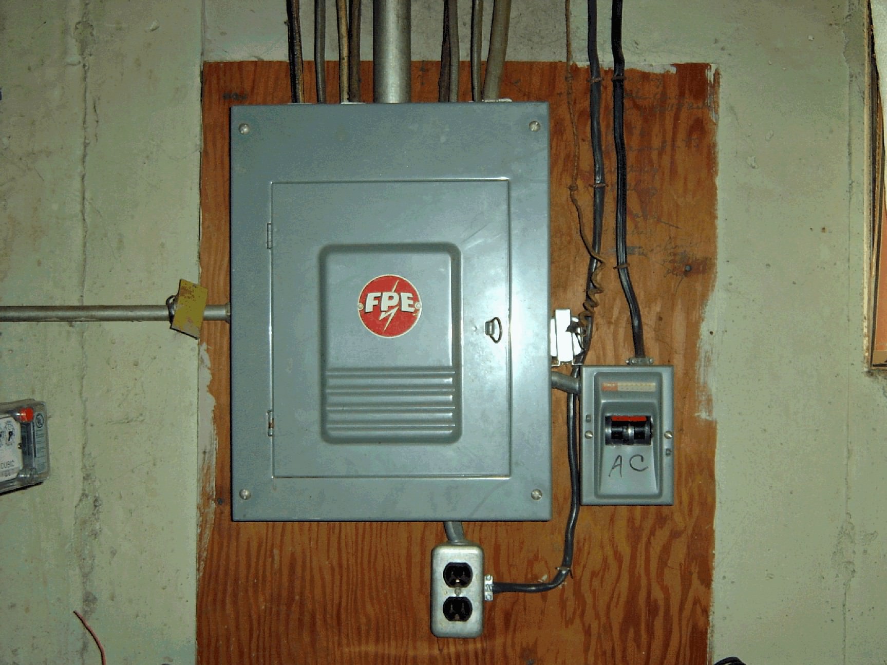

n/a29 Posted May 25, 2004 Report Share Posted May 25, 2004 Download Attachment: SV4000902.JPG 511.62 KB Download Attachment: SV4000912.JPG 637.46 KB Had my first encounter with the FPE panel that I had never heard about until this topic on TIJ. In additon to the inherent problems of the box type itself, I found a double tap on fuse #8, neutrals and grounds on same bus bar, debris in the bottom of the box, bare wires close to the casing, etc. etc. etc. Coming from the subpanel, there was a 240 volt wire going to the AC unit that had been spliced by twisting the wire together and wrapped with electrical tape. It should be no surprise that the wire had already melted and had fire hazard signs written all over it. Some people are extremely lucky!!! Quote Link to comment Share on other sites More sharing options...
crusty Posted May 25, 2004 Report Share Posted May 25, 2004 That's nothing. Wait till you get your first Stab lok, now that's scary. Quote Link to comment Share on other sites More sharing options...
DonTx Posted May 25, 2004 Report Share Posted May 25, 2004 Amazing, I haven't ever seen a FPE fuse box before. Nice decal. Thanks for the pics. Donald Quote Link to comment Share on other sites More sharing options...
