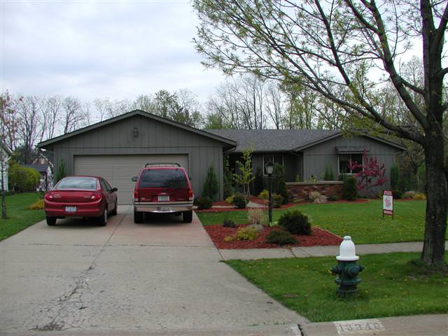

Terence McCann Posted May 1, 2004 Report Share Posted May 1, 2004 Might be a little hard to see in the picture but the siding on the front of the home is a manufactured wood siding. Technical/manufactures name for this stuff? Thanks in advance. Download Attachment: FairweatherSmall.jpg 62.75 KB Quote Link to comment Share on other sites More sharing options...
Gerry Beaumont Posted May 1, 2004 Report Share Posted May 1, 2004 Hi Terry, i may be wrong, but my first guess is that it is an 8x4 sheeting product commonly refered to as T111, or T1-11, try googling that until you find something that matches, also look at www.sidingclaims.com for more info. Sorry i can't help you more, but I'm heading for a cook out. (the sun is finally shining in New england !!) regards Gerry Quote Link to comment Share on other sites More sharing options...
Jim Katen Posted May 1, 2004 Report Share Posted May 1, 2004 Originally posted by Terence McCann Might be a little hard to see in the picture but the siding on the front of the home is a manufactured wood siding. Technical/manufactures name for this stuff? Thanks in advance. Download Attachment: FairweatherSmall.jpg 62.75 KB It's a T1-11 pattern, but I can't tell anything else. Post an up-close picture. Was it plywood, OSB, hardboard, or OSB with a hardboard facing? Was there a paper overlay? - Jim Katen, Oregon Quote Link to comment Share on other sites More sharing options...
Terence McCann Posted May 1, 2004 Author Report Share Posted May 1, 2004 Gerry, thanks for the input. BTW, that link is broken/dead. Jim, it's hardboard and has a type, of what could best be described as, a pressed wood texture. You can make out what would appear to be wood strands in the siding. Sorry, no closeup pictures (tried to zoom in and it just gets blurry). Maybe I'll zip past there tomorrow and ask the owners if I can take another pic. BTW, the home was built in 1977 if that helps. The siding was in great condition over all. Had soil contact in a few areas, moved soil away and probed, everything was solid. It was just on the front of the home, the other three sides were aluminum siding. Quote Link to comment Share on other sites More sharing options...
hausdok Posted May 1, 2004 Report Share Posted May 1, 2004 It's hard to tell from that distance, but the spacing of the channels in the T111 pattern looks like it could be Masonite's Omniwood. It was sold in the late 70's early 80's and is basically a layer of masonite just a little thicker than a 16th of an inch bonded to an OSB substrate. ONE TEAM - ONE FIGHT!!! Mike Quote Link to comment Share on other sites More sharing options...
