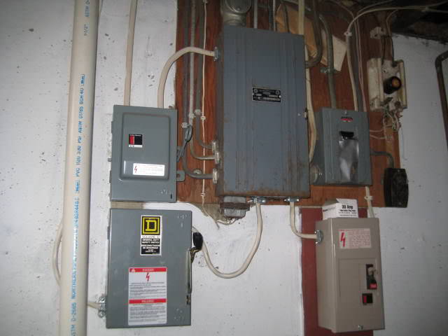

jodil Posted April 28, 2008 Report Share Posted April 28, 2008 What makes a subpanel a true "subpanel?" What I mean is, like pic 1 here, all this little panels contain two fuses probably because of lack of service in the main. They aren't all subpanels right? So what do you look for in a panel to call it a "Sub?" Image Insert: 49.2 KB Like this one... This panel is about 6 inches from the FPE main panel... Is this a subpanel? If yes, why? Image Insert: 85.48 KB Quote Link to comment Share on other sites More sharing options...
Jim Katen Posted April 28, 2008 Report Share Posted April 28, 2008 Originally posted by jodil What makes a subpanel a true "subpanel?" What I mean is, like pic 1 here, all this little panels contain two fuses probably because of lack of service in the main. They aren't all subpanels right? So what do you look for in a panel to call it a "Sub?" Like this one... This panel is about 6 inches from the FPE main panel... Is this a subpanel? If yes, why? There's really no such thing as a "subpanel." It's a slang term. In the parlance of the NEC, there are just "panelboards." There aren't different kinds. The NEC tells us to bond the neutral the grounding wires at or before the place where the service disconnect is. After that, the grounding wires and the neutral wires are supposed to remain separate. They're supposed to remain separate in panelboards, switches, appliances, fixtures, and anything else you can think of. It's easier to think of "main panels" and "sub panels" for some things, but occasionally, it causes confusion and it's good to go back to the horse's mouth for the basics. - Jim Katen, Oregon Quote Link to comment Share on other sites More sharing options...
kurt Posted April 28, 2008 Report Share Posted April 28, 2008 Given that 5 panel conglomeration in the first photo, you could make some strong arguments for taking it all out, updating the service to 200 amps, and consolidating it all into one panel. I don't know how folks do stuff in your neighborhood, but in my area, that would be called a freakshow. Quote Link to comment Share on other sites More sharing options...

Sodapop Posted May 9, 2008 Report Share Posted May 9, 2008 Tear it out and upgrade the service. Looks like they kept adding things over the years. Most of the items in the first photo are disconnects of one kind or another. If the panel in the second photo is fed from the main panel it is a "subpanel". However: The ground and neutral should be seperated by removing the bar at the bottom. Eliminate this altogether by installing a proper service upgrade. Is the FPE panel still operational or did they just feed through it? Quote Link to comment Share on other sites More sharing options...
