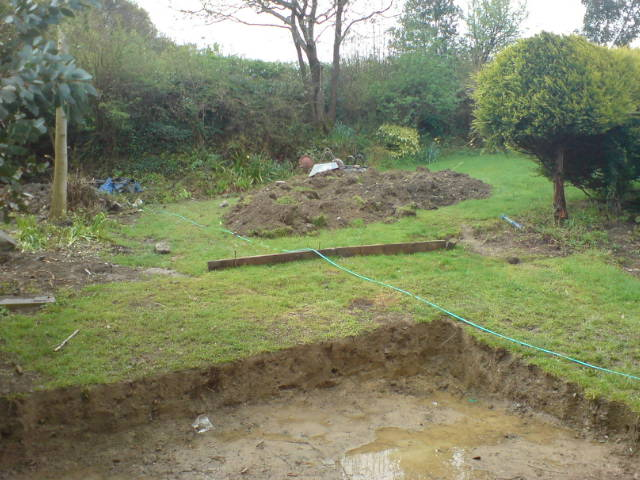

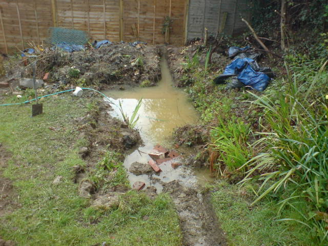

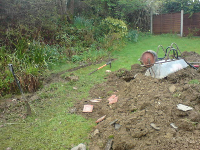

bwgan Posted April 30, 2008 Report Share Posted April 30, 2008 Bore dda, Diolch i bob lwc Bill. We had quite a bit of rain yesterday afternoon and evening, which wasn't too bad as I got to see the football and have a beer or two. This morning after walking the 'ghost' I went to check out the pond to get some more photos. I nearly had an MI, the pond was completely full! Image Insert: 922.12 KB Image Insert: 922.12 KB Image Insert: 922.12 KB Image Insert: 922.12 KB Quote Link to comment Share on other sites More sharing options...

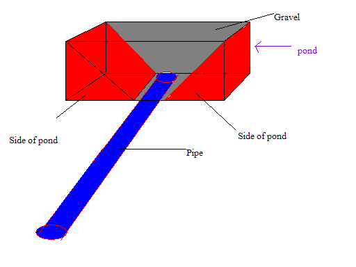

bwgan Posted April 30, 2008 Author Report Share Posted April 30, 2008 You can see from the last pic that I was starting to dig a drainage ditch and putting it into a soak away near the rickety fence. I clearly wasn't expecting that amount of water to come from the pond! I've been reading bits on the web and this is my plan. If I excavate the pond into an inverted triangle shape and put my drainage pipe at the point of the triangle (bottom of pond, then fill with gravel and then soil would that work. Then run the pipe down the garden into a drain? I've attached quick plan, please excuse its crudity Image Insert: 590.35 KB Quote Link to comment Share on other sites More sharing options...
Richard Moore Posted April 30, 2008 Report Share Posted April 30, 2008 Paul, What you are proposing looks good...sort of. Depends on a number of factors. First, I assume you can keep a good slope on the pipe all the way to a suitable drainage area? Make sure you use a good size gravel or "river rock". The small, fine stuff probably won't drain fast enough. And then you might want to put some type of fabric over the "gravel" before topping with soil to prevent that soil gradually clogging up the system. You absolutely, positively sure you don't want a pond? I heard they can be very nice with a few Koi...and maybe a little fountain and a gnome with a fishing rod. BTW...was I right about the dogs name? Quote Link to comment Share on other sites More sharing options...

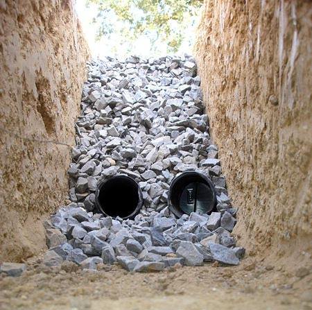

Richard Moore Posted April 30, 2008 Report Share Posted April 30, 2008 I don't think we would even call it gravel around here. More like crushed rock or the smoother river rock. I'm really no expert on this but I would tend towards something that averages at least 1" in size. And...the pipe lying in the bottom of the trench at the pond should be perforated to allow water to enter along it's length rather than just at one end. What you are creating is basically a French Drain. You can search online for installation advice. Here's a couple of photos.. Image Insert: 84.85 KB Image Insert: 25.52 KB I left in '74 but you are still talking to an Englishman from just outside London. I hope that's OK! [] Quote Link to comment Share on other sites More sharing options...
