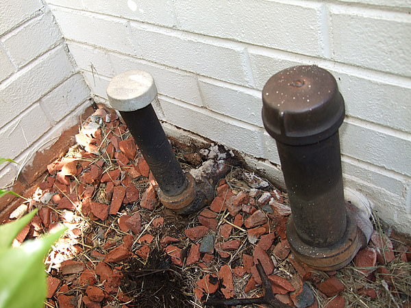

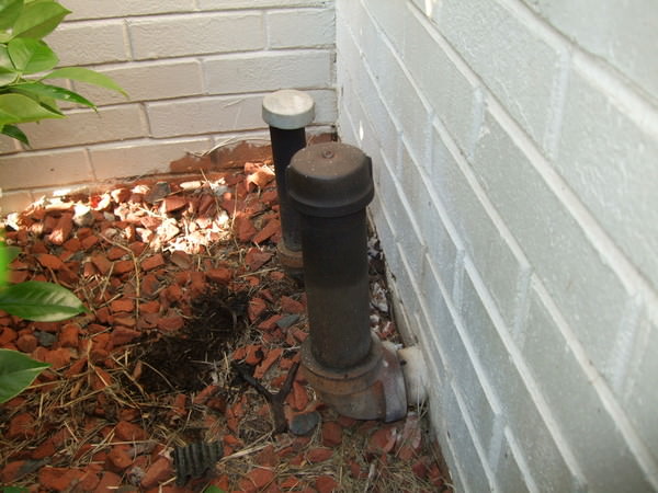

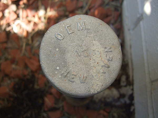

ashstars Posted May 10, 2008 Report Share Posted May 10, 2008 I am helping my parents purchase a house and am concerned about the possibility of one of the homes we are interested in having an underground oil tank. My father loves this particular home so he put down an offer on the house and $500 deposit without knowing the details of the oil tank location. The home was a foreclosure which is now owned by a realty company, so we cant contact the previous owner for info and our realtor wasnt able to give us any details on the oil tank either. I took some pictures of 2 pipes on the front side of the house....I didnt see any other pipes or holes anywhere else outside. Can anyone please tell me if these look like underground or above ground oil tank pipes? Also, when we took a tour of the house the basement smelled like oil or gasoline but we didnt see any tanks present. And it was too dark to see any wiring or piping. Several neighbors down the street had similar pipes on the outisde walls but higher up than these. any help would be very appreciated. thank you! Image Insert: 98.8 KB Image Insert: 127.06 KB Image Insert: 95.61 KB Image Insert: 116.06 KB Quote Link to comment Share on other sites More sharing options...
kurt Posted May 10, 2008 Report Share Posted May 10, 2008 If those weren't oil tank filler and vent pipes, I'd be surprised. Quote Link to comment Share on other sites More sharing options...
Steven Hockstein Posted May 10, 2008 Report Share Posted May 10, 2008 Go back with a flashlight and look for a tank in the basement or crawlspace. Better yet, hire a home inspector! Quote Link to comment Share on other sites More sharing options...
Bill Kibbel Posted May 10, 2008 Report Share Posted May 10, 2008 The oil fill and vent pipes enter the wall. The tank is likely inside the home. The only other possibility is the tank is in-ground, under the home, which would be very unlikely. Your inspector will hopefully have a flashlight and will probably discover the tank's location. Quote Link to comment Share on other sites More sharing options...

hausdok Posted May 10, 2008 Report Share Posted May 10, 2008 Hi, The smaller cap at the left in the picture is a vent the right is the filler. No offense meant, but I'm concerned; you say you're helping your father to get this home but you aren't hiring a home inspector, you have focused on the oil tank, but you don't have the feintest idea of what to look for. What about the rest of the home? While I agree that a leaking tank is a bad thing, there are many, many other things that could be going on in that house that will escape the attention of an inexperienced person. You could solve this tank mystery, your dad buys the home while thinking that the rest of it's in acceptable condition, and then he could end up discovering many thousands of dollars worth of needed repairs the hard way. If your reluctance to hire an inspector is due to cost, keep in mind that an inspector could find just one electrical issue that needs correction that you wouldn't be experienced enough to spot and it would more than justify the inspector's fee. You do not want to see your father saddled with a mortgage on a home that will suck him dry due to a bunch of seemingly small but expensive issues that you and he wouldn't have known to look for. Spend whatever it will cost in your area to get the most experienced inspector around to give that house the once over. If you don't; mark my words, you're liable to be very sorry. ONE TEAM - ONE FIGHT!!! Mike Quote Link to comment Share on other sites More sharing options...

Jim Katen Posted May 10, 2008 Report Share Posted May 10, 2008 My observations: There's no question in my mind that those are oil tank fill & vent pipes. The pipes turn and head through the wall. That means that the tank is/was under the house -- probably in the basement. The vent pipe is awfully short. Don't you get snow in NC? The pipe is supposed to be tall enough to keep it up out of the snow. - Jim Katen, Oregon Quote Link to comment Share on other sites More sharing options...
