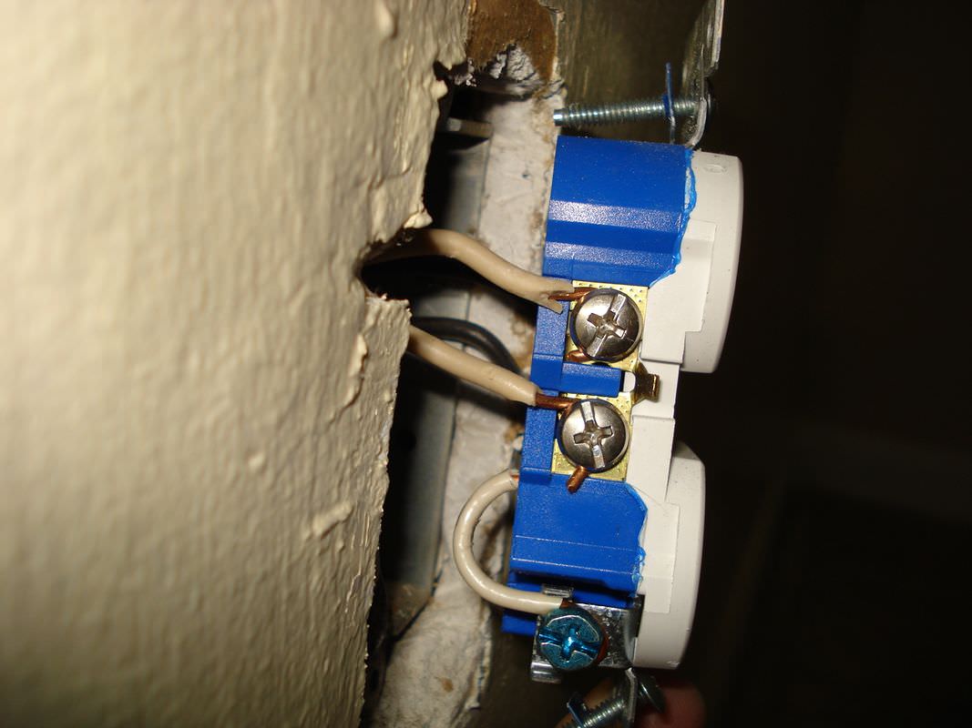

Bain Posted June 6, 2008 Report Share Posted June 6, 2008 Does anyone routinely remove outlet cover-plates? I don't, but maybe I'll begin doing so. I was in an older house this afternoon. The electrical panel had only one or two ground wires connected to the terminal bar. No big deal, right? But then I began checking the outlets, and my tester proudly displayed that everything was up to snuff. But then I remembered the lack of ground wires in the panel, and removed a cover-plate. What did I discover? An infamous bootleg ground. I checked only one other outlet, and found the exact same thing, and told the client an electrician should examine every outlet in the place and make necessary corrections. But then I got to wondering . . . how many of these things have I missed in the past? The $300.00 tester I use is supposed to identify bootleg grounds, but it was completely fooled. Image Insert: 108.71 KB Image Insert: 99.11 KB Quote Link to comment Share on other sites More sharing options...

Billy_Bob Posted June 7, 2008 Report Share Posted June 7, 2008 That little jumper to ground can be quite dangerous! A common electrical problem is a loose connection at wiring connections. Another outlet "upstream" could have a lose wire nut connection on the white wire feeding that outlet for example. Wires "pushed" into the holes in the back of outlets rather than wrapped around the screws frequently come lose. If you lose the white wire (neutral connection) to that outlet, then the metal case of an appliance plugged into that outlet (direct connection to ground wire on outlet) would become energized! Zapppp! Basically the metal case on the appliance would have a direct connection to the black "hot" wire via the plugged in appliance. Quote Link to comment Share on other sites More sharing options...

Bain Posted June 8, 2008 Author Report Share Posted June 8, 2008 One, it's foolish for you to presume you know anything about me or my qualifications. Two, I wasn't referring to all electricians, merely the ones described by Erby. Three, the house containing the bootleg grounds recently had its entire electrical system "completely upgraded" by an electrical contractor. Whether the contractor overlooked the flubs in the photos--along with several others--or created them, we'll never know. Quote Link to comment Share on other sites More sharing options...
wirenut1110 Posted June 8, 2008 Report Share Posted June 8, 2008 If a licensed individual did this, they should be reported. There is absolutely no excuse for this except to deceive and is dangerous. If they did this one, they're probably doing others. Quote Link to comment Share on other sites More sharing options...
hausdok Posted June 8, 2008 Report Share Posted June 8, 2008 OK, OK, Enough with the testosterone. John initiated the thread to point out an issue that's common with all of us - we inspect the interior of panels and then go through the homes, attics, crawlspaces, and basements doing a visual on the wiring methods used and making certain that the things we see are done correctly and safely, but we don't routinely remove the covers of every switch and receptacle in the home to inspect the connections - nor do we open up and examine the interior of every J-box found in an attic or crawlspace - so it's possible that we'll miss stuff. Not exactly news but a "visual" inspection is what it is. By the way, according to the feedback I've had over the years, electricians also don't routinely remove every switch or receptacle cover, and open up every junction box and fixture to check for proper strain relief and connections, when they're called out to inspect a system based on our recommendations. If an electrician was supposed to have recently "completely upgraded" the electrical system in that home, than he is the most likely suspect to have done this - not the homeowner. One could assume that the homeowner pulled out all of the old 2-slot receptacles, replaced them with 3-slot types, and then added the bootleg pigtails, but it would have been the electrician who would have been in a position to know that the wiring in the pre-60's house didn't have any EGC's and, if it wasn't the electrician who installed them, it would have been the electrician's responsibility to check all of those new 3-slot receptacles to determine how they'd been grounded. Not finding any EGC's and finding the bootleg grounds, it would have been the electrician's duty to have corrected those. So, we have to presume that either 1) it was the electrician who installed all of the bootleg grounds in order to get around the work necessary to "completely upgrade" the electrical system, 2) the electrician was either negligent or an idiot, or 3) the story about the electrician recently upgrading the system is hyperbole from a realtor or seller and that the only thing that the electrician actually did was replace the service panel 'cuz that's what they'd ordered. Personally, I'd suspect the last scenario 'cuz that's what I see most often being the case. Thanks John for assuaging my fears that when I chose the SureTest over that other gizmo many years ago I was making the wrong choice. ONE TEAM - ONE FIGHT!!! Mike Quote Link to comment Share on other sites More sharing options...

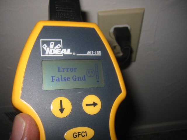

Inspectorjoe Posted June 8, 2008 Report Share Posted June 8, 2008 This has been a valuable thread. I have to admit to getting really lazy by relying on a three light tester. Yesterday I vowed to ditch the three light tester and use only the suretest, which admittedly hasn't come out of the bag as often as it should have. I hit pay dirt at the very first house. Image Insert: 74.05 KB Quote Link to comment Share on other sites More sharing options...

Kyle Kubs Posted June 10, 2008 Report Share Posted June 10, 2008 Originally posted by Inspectorjoe This has been a valuable thread. I have to admit to getting really lazy by relying on a three light tester. Yesterday I vowed to ditch the three light tester and use only the suretest, which admittedly hasn't come out of the bag as often as it should have. I hit pay dirt at the very first house. Image Insert: 74.05 KB Joe - Just incase your not aware, the suretest can give you a false reading of a false ground if you are too close, within 10' of the main panel due to the fact that the Neutral and ground are bonded there. If the panel was just under your feet in the basement you may have had a false reading. On a side note. I chose the Suretest over the three light years ago for the fact that it detected false grounds and gave other info I thought might be useful, but since then have been continuously frustrated with the poor quality of the instrument itself. It is by no means 100% reliable. Mine is on limited time before it makes a trip to the rifle range with me to serve as a target of satisfaction. Not sure what I will replace it with. Quote Link to comment Share on other sites More sharing options...

Inspectorjoe Posted June 11, 2008 Report Share Posted June 11, 2008 Kyle: Yes, I know about possible false readings when in close proximity to the main panel, but now that you mention the scenario of a panel on the level below, I have to wonder if there have been any times when that might not have 'registered' with me. As far as not being 100% reliable, I know what you mean. Mine will work fine, but then suddenly go dead. Then, the next time I pull it out, it will work just fine. Maybe that's why I've been mostly leaving it in the bag for a long time now. Quote Link to comment Share on other sites More sharing options...
