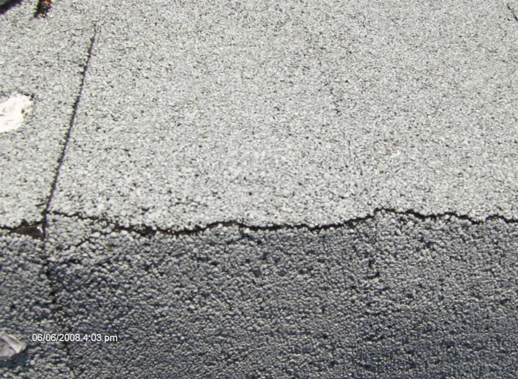

John Dirks Jr Posted June 9, 2008 Author Report Share Posted June 9, 2008 Now that you mention it Brian, I understand how they could be damaged by being bent in colder weather. Thanks for enlightening me to that possibility. Here's a picture of one of the caps. What do you think? Does the jagged nature of the split provide a clue? Image Insert: 207.94 KB Quote Link to comment Share on other sites More sharing options...

Brian G Posted June 9, 2008 Report Share Posted June 9, 2008 Mike, it was that three martini breakfast that got you. [:-dev3] Originally posted by AHI Here's a picture of one of the caps. What do you think? It certainly doesn't look like age and wear. I'd say it was either put on cold in the winter or the quality sucked to start with. I always recommend replacing 'em when they look like that; others may vary. Brian G. Heatum & Bendem Roofers Inc. [] Quote Link to comment Share on other sites More sharing options...
Jim Morrison Posted June 9, 2008 Report Share Posted June 9, 2008 Personally, I wouldn't even mention a cracked cap shingle, unless it was causing a problem; and I don't ever remember seeing one that caused a problem. I've seen hundreds of slate roofs without cap flashings or arris lines flashings leaving as much as 1/4 wide opening at the peak of the ridge and arris line for 80-100 years. The wood was stained, but there was no damage. Quote Link to comment Share on other sites More sharing options...

Mark P Posted June 9, 2008 Report Share Posted June 9, 2008 Originally posted by Jim Morrison Personally, I wouldn't even mention a cracked cap shingle, unless it was causing a problem; and I don't ever remember seeing one that caused a problem. I've seen hundreds of slate roofs without cap flashings or arris lines flashings leaving as much as 1/4 wide opening at the peak of the ridge and arris line for 80-100 years. The wood was stained, but there was no damage. I'll admit I had to look "arris" up, maybe I'm not the only one so here ya go" "ARRIS: The angle, corner, or edge produced by the meeting of two surfaces; the edge of external angle. A natural or applied line on the stone from which all the leveling and plumbing is measured." (http://www.selectstone.com/glossary.htm) Quote Link to comment Share on other sites More sharing options...
