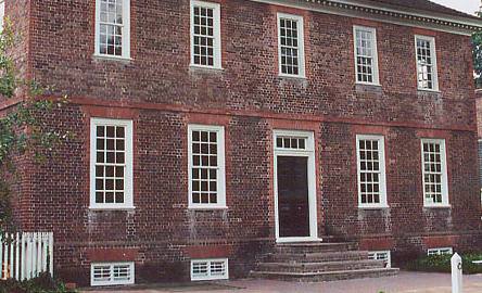

Bill Kibbel Posted June 28, 2008 Report Share Posted June 28, 2008 Originally posted by Brian G ...what the heck is a belt on a chimney? [?] Don't you have them down there? In masonry, a "belt course" is a horizontal projecting course. On older chimneys, it usually refers to a projecting course directly above the flashing. Some use the term for a projecting course commonly found 1 or 2 below the top course. I've been told that the there is a minor crack or two in the crown and belt of the chimney by a roofer. He mentioned he would simply use silicone caulk in the cracks If it's originally made with masonry materials, Why squirt goop for a repair? Quote Link to comment Share on other sites More sharing options...

Brian G Posted June 28, 2008 Report Share Posted June 28, 2008 Gracias Bill. Down here we just call that a horizontal projecting course. [] Brian G. The Well-Dressed Chimney: A Belt and a Cap [:-tophat] Quote Link to comment Share on other sites More sharing options...
