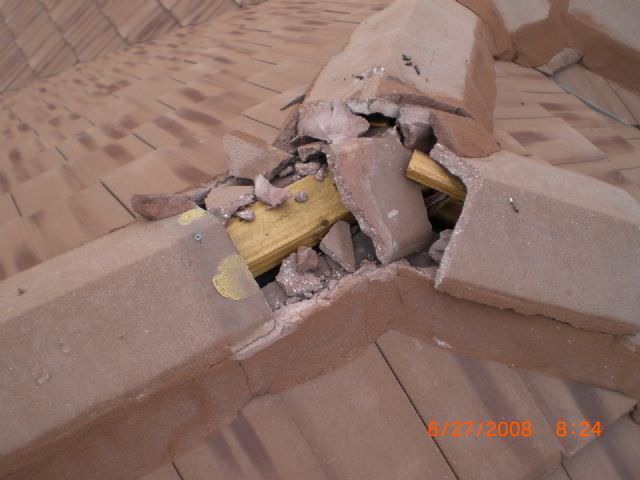

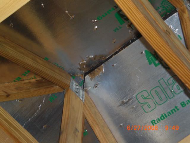

SteveSarasota Posted June 30, 2008 Report Share Posted June 30, 2008 Hello, I did a job Friday on a house built in 2003, concrete tiles roof, one of the ridge tiles was missing. Not cracked, like something heavy stood on it and the parts of the tiles were at the bases of the valleys. The roof was fairly steep 7/12 or so. When I went inside the attic and looked up, I saw what seemed like a moisture stain under the missing tile. The sheathing had the radiant heat barrier attached to the underside of the sheathing and that little section was missing. The tenant claims that the house was hit by lightning while they were away in GA. The pool panel was also fried and they found 4 burned kitchen bulbs when they came back. Does this look like lightning strike to you? See there are no burn marks whatsoever on the ridge and on the visible 2x4. Thanks for your time and patience. SteveR Image Insert: 558.86 KB Image Insert: 555.51 KB Quote Link to comment Share on other sites More sharing options...
Jesse Posted June 30, 2008 Report Share Posted June 30, 2008 Lightning will do some wicked stuff, traveling along gutters/downspouts, conduit, flues, etc. I'd expect, though, that there'd be some evidence of heat on the lumber just below the broken shingles. As it is in the photo, it just looks like a broken shingle. Perhaps they did get a lightning strike, but not at that location. I was on the roof of a suburban high school after a storm. Their lightning detector (for the athletic fields) had taken a direct strike. The damage and the irony were beautiful. Quote Link to comment Share on other sites More sharing options...
Eric B Posted June 30, 2008 Report Share Posted June 30, 2008 Looking at both pictures I'd say it likely was lightening but I'm amazed that there is no scorching of the wood. Quote Link to comment Share on other sites More sharing options...
Mike Lamb Posted June 30, 2008 Report Share Posted June 30, 2008 Maybe a rodent (or man). Not likely lightning. Lightning strikes measure 15,000 to 60,000 degrees F. Jesse ain't kidding when he says, "wicked." Even "cold" lightning would leave a mark. The gussets would be fried. Nope, not lightning. Quote Link to comment Share on other sites More sharing options...
