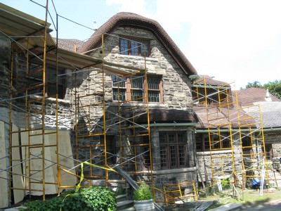

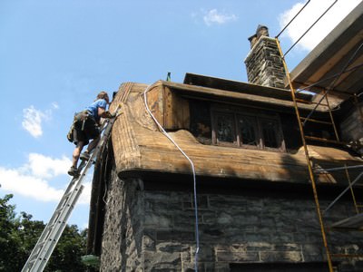

Brad Manor Posted July 11, 2008 Report Share Posted July 11, 2008 Some friends of mine have been asked to replace the roof on this 1927 home. The house carries some historic significance: it was once owned by Paul Martin Sr. who was, at one time Canada's finance minister. His son later went on to become finance minister, then Prime Minister. The house was recently sold and is being renovated. Image Insert: 58.08 KB Image Insert: 64.09 KB Image Insert: 61.91 KB Image Insert: 49.24 KB The plan for the new roof is to form cedar shingles to the roof deck. -Brad Quote Link to comment Share on other sites More sharing options...
AHI in AR Posted July 11, 2008 Report Share Posted July 11, 2008 Question for the day: How much Molson's does one have to imbibe before building a curved roof seems like a good idea?[] Quote Link to comment Share on other sites More sharing options...
Brad Manor Posted July 11, 2008 Author Report Share Posted July 11, 2008 Not only is it curved, it's wavy. They figure the whole job will take close to 3 months. The local Beer Store should have a good year! -Brad Quote Link to comment Share on other sites More sharing options...
Bill Kibbel Posted July 11, 2008 Report Share Posted July 11, 2008 It was designed and built to have a thatched roof. Installing cedar shingles would be an insult. Quote Link to comment Share on other sites More sharing options...

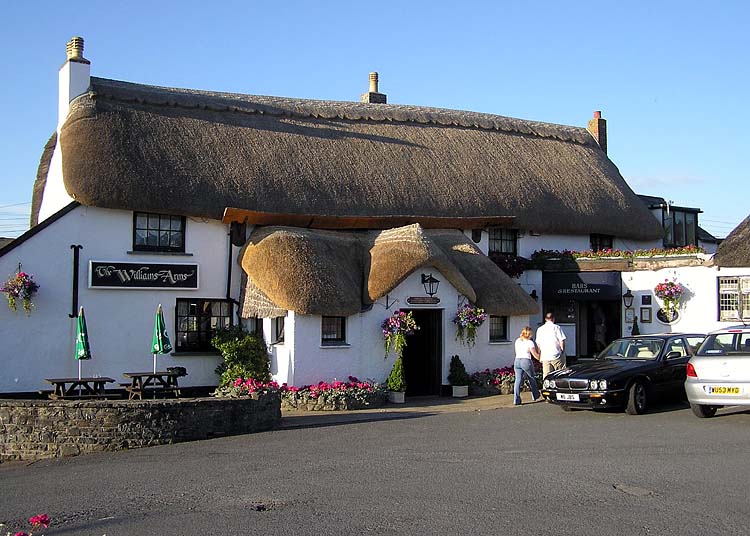

Bain Posted July 11, 2008 Report Share Posted July 11, 2008 It may be insulting, Bill. But how does one locate a thatched-roof installer? Do they have them in PA? Image Insert: 109.85 KB Quote Link to comment Share on other sites More sharing options...

SonOfSwamp Posted July 12, 2008 Report Share Posted July 12, 2008 Originally posted by inspecthistoric It was designed and built to have a thatched roof. Installing cedar shingles would be an insult. Some time back, I'm sure I saw photos of such roofs covered with shingles, which were steamed and bent to fit the contours of the roof. Was that a bad practice, or has that practice ended? I'm just curious... And wouldn't the owners have to get a real enough English thatcher to thatch that roof? No thatch in Nashville, WJid="blue"> Quote Link to comment Share on other sites More sharing options...
hausdok Posted July 12, 2008 Report Share Posted July 12, 2008 Originally posted by Bain It may be insulting, Bill. But how does one locate a thatched-roof installer? Do they have them in PA? They have them close by. I remember reading about a young fellow from Ireland who lives in Virginia and has a business travelling around the country to install and/or repair thatched roofs. If memory serves, his biggest difficulty is finding the proper kind of thatch. Bill, It looks like a solid deck; weren't thatched roofs installed over skip? Is it possible that it was originally built to have a roof that mimics a thatched roof but with locally grown materials; namely cedar shingles? We have a couple of those here. They might have looked pretty cool when they were built back in the 20's and 30's and the roofs were cedar shingles; however, since then, some nimrod owners have swapped out the cedar for comp and to my eye's they are an eyesore. Here are a few companies that do the cedar roof "insult" thingy; the first two are the same company - they actually do thatch roofs in addition to the insult roofs. Check out these portfolios: Huber #1 Huber #2 Cedar Roof Design Inc. Ganser Company ONE TEAM - ONE FIGHT!!! Mike Quote Link to comment Share on other sites More sharing options...
Bill Kibbel Posted July 12, 2008 Report Share Posted July 12, 2008 Originally posted by Bain It may be insulting, Bill. But how does one locate a thatched-roof installer? Do they have them in PA? I highly recommend Colin McGhee. He's from VA, but has thatched throughout N. America. I've had the pleasure of reviewing his work. He's a true master thatcher. www.thatching.com/portfolio.shtml Also, here's where home inspectors can learn about spars, liggers and wadds: www.thatchedhomeinspector.co.uk/ Quote Link to comment Share on other sites More sharing options...
Bill Kibbel Posted July 12, 2008 Report Share Posted July 12, 2008 Originally posted by hausdok Bill, It looks like a solid deck; weren't thatched roofs installed over skip? Is it possible that it was originally built to have a roof that mimics a thatched roof but with locally grown materials; namely cedar shingles? We have a couple of those here. They might have looked pretty cool when they were built back in the 20's and 30's and the roofs were cedar shingles; however, since then, some nimrod owners have swapped out the cedar for comp and to my eye's they are an eyesore. I don't know what the existing thatch is over. The right way is to secure maple sapplings to the rafters as purlins/battens. I'd bet anything that the cottage was designed and built to have a thathed roof. Why put on a 20 year cedar roof when it deserves 70 year thatch. Quote Link to comment Share on other sites More sharing options...
