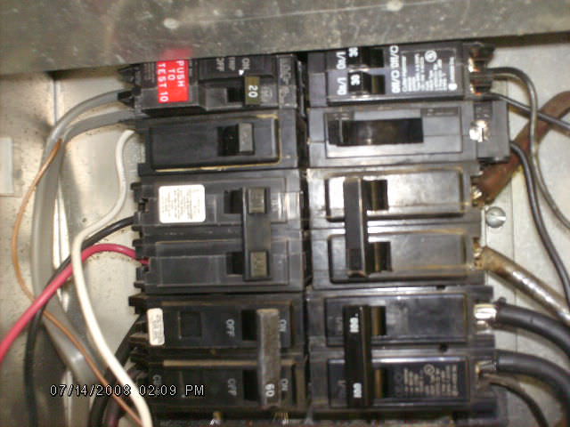

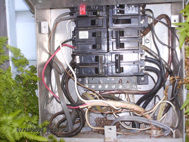

Phillip Posted July 15, 2008 Report Share Posted July 15, 2008 Exterior panel designed for 6 240 volt breakers. Image Insert: 142.47 KB Image Insert: 102.24 KB Does anyone have a panel with more? Quote Link to comment Share on other sites More sharing options...
Brian G Posted July 15, 2008 Report Share Posted July 15, 2008 I don't know about more, but I've seen similar situations plenty of times over in Bama. No one has ever been able to tell me why Alabama Power thought having all of the 240v breakers outside was such a wonderful idea, but they did it that way for a long time. The inside panel, with all of the 120v breakers, was always right across the wall inside the house, but was never, ever, wired as a sub panel. Goofy. Brian G. Strange Ideas [:-alien] Quote Link to comment Share on other sites More sharing options...
msteger Posted July 15, 2008 Report Share Posted July 15, 2008 Personally, I think having the breaker panel outside is just plain nuts. Quote Link to comment Share on other sites More sharing options...

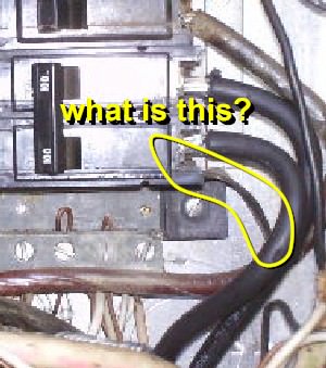

Richard Moore Posted July 15, 2008 Report Share Posted July 15, 2008 2nd breaker down on the left isn't being used. "Room for expansion!" Besides the multi-tapped neutrals, no retaining screw for the back-fed main, and lack of panel bonding(?), there is a small conductor that seems to be attached to the main breaker lug at the bottom right. It goes from there to behind the SECs but then seems to disappear. Any idea what that is? Image Insert: 45.21 KB Quote Link to comment Share on other sites More sharing options...
Phillip Posted July 16, 2008 Author Report Share Posted July 16, 2008 Just another wire. Not sure where it went. Client walked. Quote Link to comment Share on other sites More sharing options...
