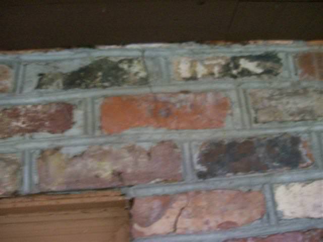

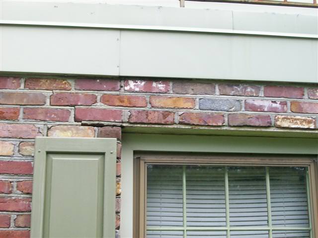

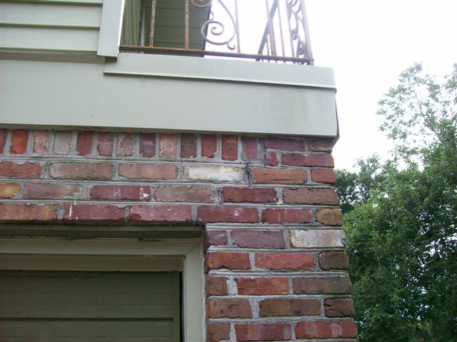

palmettoinspect Posted July 18, 2008 Report Share Posted July 18, 2008 Hey guys got a quick question I did a home last week and got brick cracks at the front garage window lintels, the garage door lintel and rear french door lintel. I called it sagging lintel at the rear french door and minor to normal settlement at the garage window and doors. Lintels are installed at all windows and doors. The home is well built in the late 60's in Charleston South Carolina. The garage door and rear french doors didnt concern me as much as the front garage window did. My issue is the seller wants to meet tomorrow and go over the cracks he said they are caused by rusted lintels. What do yall think any input would be nice. Thanks Kiel Image Insert: 48.52 KB Image Insert: 36.76 KB Image Insert: 54.3 KB Quote Link to comment Share on other sites More sharing options...
kurt Posted July 18, 2008 Report Share Posted July 18, 2008 Yes, rusted and delaminated lintels. We call it *lintel jack* up here. The steel rusts, delaminates, and expands outward w/thousands of pounds of force. Very slowly, but very firmly. The vertical flange on the angle iron is probably totally gone, or at minimum, badly delam'ed. It's not sagging lintels, it's warped/delam'ed/rusted lintels. Quote Link to comment Share on other sites More sharing options...
palmettoinspect Posted July 18, 2008 Author Report Share Posted July 18, 2008 Okay thanks I got some explaining to do what should I say??? and is there anything that could be done or needs to be done? Quote Link to comment Share on other sites More sharing options...

charlieb Posted July 18, 2008 Report Share Posted July 18, 2008 Originally posted by kurt Yes, rusted and delaminated lintels. We call it *lintel jack* up here. The steel rusts, delaminates, and expands outward w/thousands of pounds of force. Very slowly, but very firmly. The vertical flange on the angle iron is probably totally gone, or at minimum, badly delam'ed. It's not sagging lintels, it's warped/delam'ed/rusted lintels. Kurt, In photo 2, how would this expansion shear the brick that are above the lentel? I can understand such force on the brick that is not supported by the lentel. Quote Link to comment Share on other sites More sharing options...
palmettoinspect Posted July 18, 2008 Author Report Share Posted July 18, 2008 Originally posted by charlieb Originally posted by kurt Yes, rusted and delaminated lintels. We call it *lintel jack* up here. The steel rusts, delaminates, and expands outward w/thousands of pounds of force. Very slowly, but very firmly. The vertical flange on the angle iron is probably totally gone, or at minimum, badly delam'ed. It's not sagging lintels, it's warped/delam'ed/rusted lintels. Kurt, In photo 2, how would this expansion shear the brick that are above the lentel? I can understand such force on the brick that is not supported by the lentel. That is the reson I called it "normal to minor settlment" One more thing I might add this house is marsh front so hairline cracks in bricks is pretty common but the gap that I saw in the 1st picture made me a little concerned. AND this is a "sellers inspection: paid for by the listing agent. That is why the home owner wants to "talk" about the cracks. Kiel Quote Link to comment Share on other sites More sharing options...
palmettoinspect Posted July 18, 2008 Author Report Share Posted July 18, 2008 SonofSwamp, Great words you are right. I did recommend a contractors evaluation of the cracked brick. So think im covered I just want to make sure the cracks are minor settlement or sagging lintels. Quote Link to comment Share on other sites More sharing options...
kurt Posted July 18, 2008 Report Share Posted July 18, 2008 Originally posted by charlieb[br Kurt, In photo 2, how would this expansion shear the brick that are above the lentel? I can understand such force on the brick that is not supported by the lentel. It's lintel, not lentel. The damage can be all sorts of ways. The lintel is warping, twisting, rusting, lifting, and probably settling in there too. There's no need to open the wall to find out what the problem is. The problem is obvious. Also, by the time you open up the wall you are 7/8's of the way to fixing it anyway, so just put in a new lintel, wrap it in flashing and be done with it. It's not going to do anything fast. It's going to keep doing what it's doing very slowly. Inexorably, glacial paced, but inevitable. This is Masonry 101. You know all that flashing we are (supposed to be) recommending over windows? This is why. Isolate the lintel from moisture, it doesn't rust. Install it directly in masonry without any protection or flashing, and they rust out. I think there are also very distinct differences in quality of steel. Some of the newer steel I see rusts badly in a year, while some of the really old "blue" steel is 75 years old and still in satisfactory condition. Could've been some crappy steel back in the 60's, which would accelerate the process. Quote Link to comment Share on other sites More sharing options...

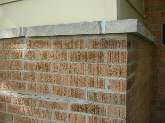

Steven Hockstein Posted July 18, 2008 Report Share Posted July 18, 2008 There are many reasons for cracks. I think Kurt is right in this case but I have also seen some unusual shear cracks caused when an overspanned lintel or girder deflects in the middle and there is uplift at the ends. (You can see a simple example of this type of uplift with two pencils and a plastic straw by setting the straw on the pencils that are laying about an inch in from the ends and pressing down on the middle of the straw). Quote Link to comment Share on other sites More sharing options...

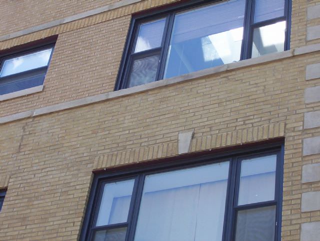

Mike Lamb Posted July 18, 2008 Report Share Posted July 18, 2008 Image Insert: 463.14 KB This building showed signs of lintel failure and lintel replacement. New steel. Weeps. The estimates I have been given for single window residential around here are $800 - $1,000 for lintel replacement of about a 4' span. Quote Link to comment Share on other sites More sharing options...
Eric B Posted July 18, 2008 Report Share Posted July 18, 2008 Funny thing about lintel repair is that few contractors want to do the work that's necessary. They simply remortar the spreading joint and fail to recognize (or hope that no one catches on) that the lintel is going to continue it's expansion. No matter what, a proper repair is going to involve hauling that lintel out. Image Insert: 139.78 KB Quote Link to comment Share on other sites More sharing options...
